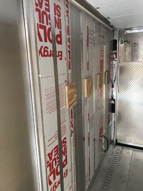

Postby featherliteCT1 » Mon Jun 05, 2017 5:47 pm
Here is the first layer of 1 inch polyiso on the curbside wall, in the rear. I screwed 3/4 x 7 inch pieces of plywood onto the studs to screw the e-track into later on. I will have to mount the bottom of the e-track about 46 inch from the floor because the top of the fairing on my motorcycle is about that height and I do not want the fairing to get nicked up by the e-track.
Rear Curb Wall insulation (480x640).jpg (199.21 KiB) Viewed 4196 times

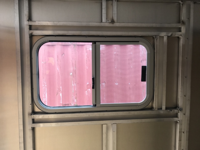

Postby featherliteCT1 » Mon Jun 05, 2017 6:12 pm
Here is the curbside window with the retaining ring removed. You can also see the aluminum window framing the factory installed into which the window is installed.
Curb Window inside (640x480).jpg (134.17 KiB) Viewed 4192 times

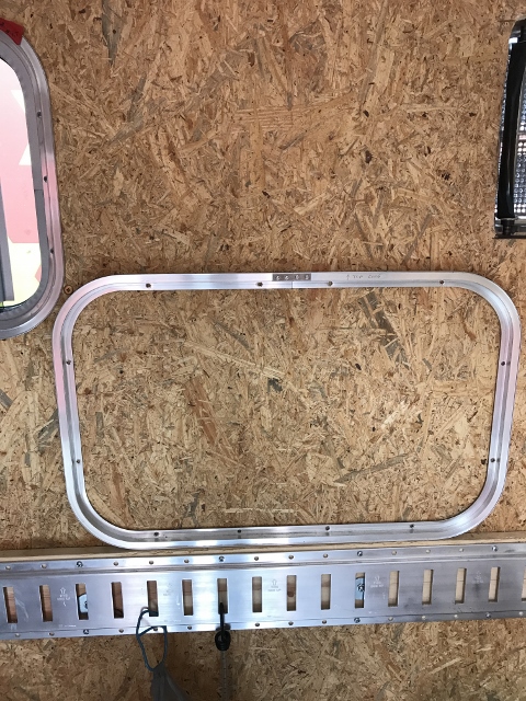

Here is the window retaining ring. It is 1/2 inch thick, which is the same thickness as the factory inner lining of OSB plywood. I have not yet figured out how to secure the window given that I am installing 1 3/4 inch of insulation plus whatever thickness of inner plywood lining I intend to install. I am currently thinking about cutting a matching window hole into some thin plywood and screwing the plywood frame onto the factory aluminum wall framing, then installing the retainer ring, then installing the 1 3/4 inch polyiso on top of the plywood framing. The effect would be that 1 3/4 inch of raw foam would be visible inside the opening which would need to be dealt with. Maybe I could fabricate some kind of oval window garnish to fill the void. I would appreciate any advice you could give me.
Curb Window frame (480x640).jpg (269.01 KiB) Viewed 4192 times

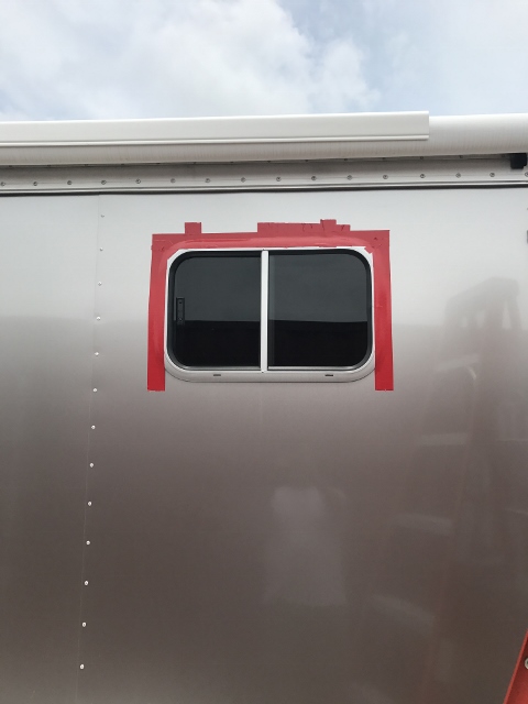

I put some duct tape around the window to keep it from falling out when I removed the retaining ring from the inside wall.
Curb Window outside (480x640).jpg (99.19 KiB) Viewed 4192 times
