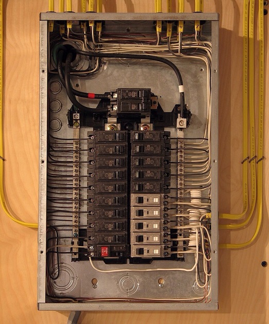

The first photo is not my work but what I would have liked my finished effort to look like... A Dream Breaker Box! What a nice piece of work...

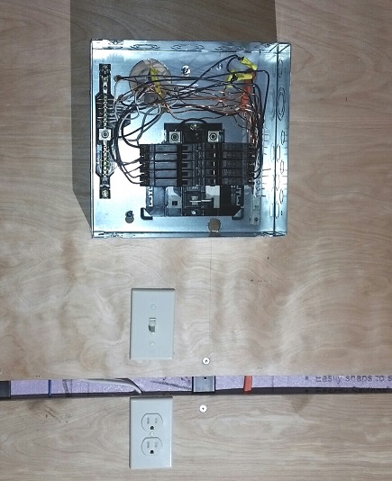

Well its time to wake up and take a look at what I really accomplished. It's not quite awe-inspiring, nor does it come close to Honorable Mention, I just hope folks don't think I hired a blind electrician without arms! If I ever do it again, I think I could do a considerable better job, but hopefully this will work for now.

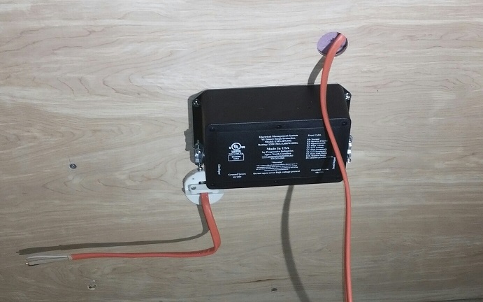

Here is a photo of my Progressive Industries' Hardwired Electrical Management System (EMS). It should provide full surge and electrical protection against all adverse power conditions. I hope to get it wired in the next day or so. It looks pretty simple, but so is life if you know what you are doing :-) The shorter cable is shore power coming in from the outside. The longer cable goes up to my Main Breaker Box. This set up will inside one of my base cabinets. I'll just make a cut-out where it will go.

Getting all the wires nice and neat and all uniform in panels takes a little skill. I am not an electrician, but I have wired a few and replaced a few panels in my time and each time they look a little better. As long all the wiring is properly connected, it is all the same when you put the front panel on. Good for you for tackling the project. :thumbsup:

Well... after a few moments gazing at my "Breaker Box Jambalaya", I think that I might be able to straighten out the Black/Hot wires and clean up the appearance a bit. It kinda looks like Phyllis Diller's hair!
