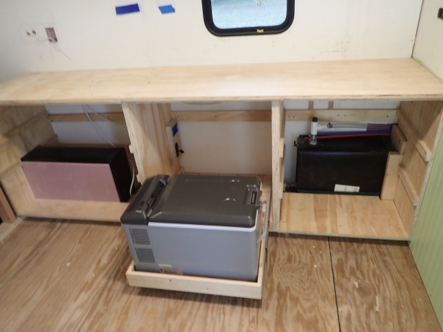

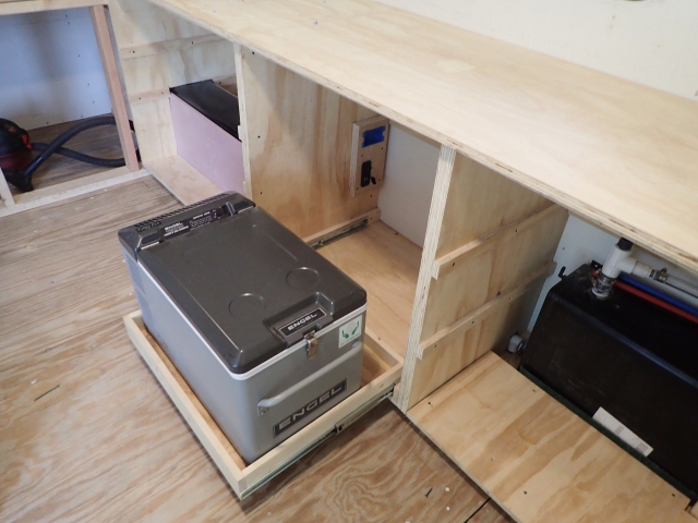

Kitchen cabinets. These cabinets are a little heavy but we needed them to support a pull out drawer for the Engel Fridge. Here is a pic of the partially completed cabinets.
Here is a pic of the Engel pulled out. The 120 and 12 volt receptacles for the fridge are in the back of the cabinet that holds the fridge. The drawer glides hold 125 pounds. The Engel is only 60 lbs.
Here is the clearance on the drawer when it is pulled out.

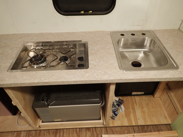

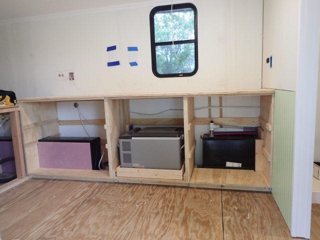

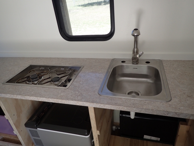

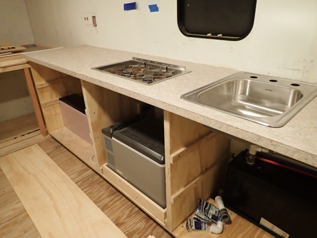

Kitchen cabinets with formica on counter top, also with stove top and sink in place. Next is finishing the hooking up of the water lines and drain lines for the sinks. Also running the propane line to the stove. Then the shelves will be installed, the faces of the cabinets and attaching the doors to the cabinets will be the end of the cabinet work.
Kitchen cabinets

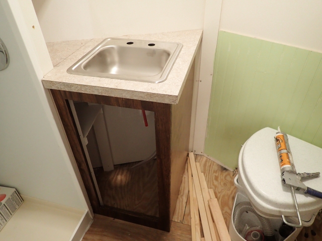

Better view of stove top and sink. We will swap the stove from the trailer back to our little boat before our next boat trip. It takes 15 minutes to unhook, move and hook the stove back up.

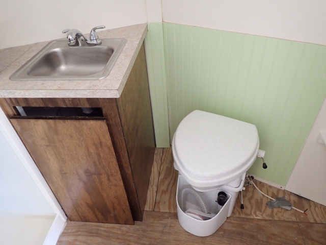

Our bathroom cabinet with formica top and sink.

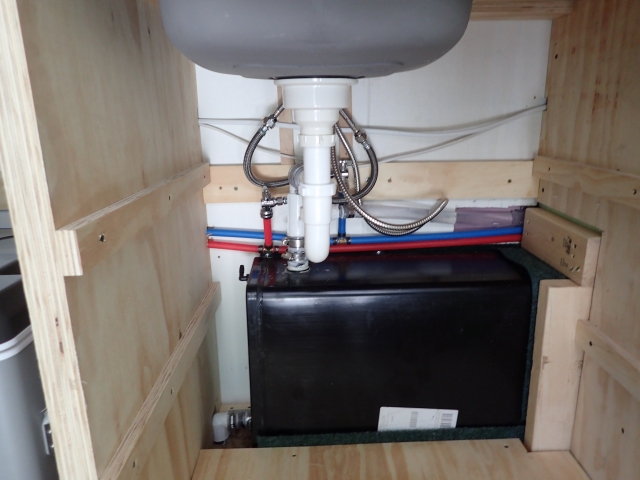

We are back home and starting to work on the camper. Thanks for all your words of encouragement. We have tested out the water and drain systems and they all work. Here is some pics of the formica
counter tops with the sink faucets installed and hooked up. Also the sink drains are hooked up to our one gray water tank.
Kitchen sink
Under kitchen sink
Bathroom sink

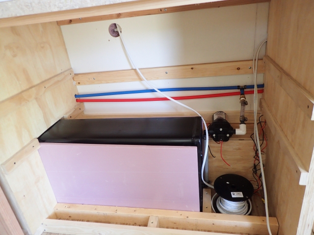

Water pump hook up. The hose from the tank to the pump is vertical so you can see the water level of the tank in the tube.

Postby Hader » Wed Mar 28, 2018 6:30 pm
Richard,
Do you have a link where you got the water tank?
Nice work :thumbsup:
Hader
Posts: 307
Images: 84
Joined: Mon Jul 04, 2016 5:00 am
Re: ris 8.5 X 18 new trailer build 11/1/17
Postby featherliteCT1 » Wed Mar 28, 2018 7:38 pm
Beautiful work!
featherliteCT1
Posts: 1167
Location: Southern Indiana
Postby ris » Thu Mar 29, 2018 4:35 am
Here is the link. Bought it at Amazon, it is a valterra water tank. You have to buy ABS fittings and glue to add large fittings to the tank. It only has 3/8 or 1/4 holes in the tank. Only 1 hole is open but they all have female threads. There are about 6 possible openings in the end of each tank. You open by drilling through the sealed off portion at the back of the threads. but do not mess up the threads when drilling open the sealed off opening. You have to buy the fittings extra if you need a 1 inch opening for a drain like I did. Valterra sells a kit with different fittings and glue. The fitting kit was about $14 and the tank was about $130.
