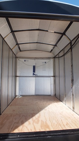

As promised, but a tad late, here is a picture of my insulation work. I still have the top bulkhead part to do, which is going to be a real challenge. It is both deeper, and higher than the rest of the bulkhead wall. Not sure why it is so much deeper.
Once I have that done, I can then seal any cracks with what insulation I have remaining, and then seal everything up with the aluminum reflective tape.

Nice job, looks neater than my work.

Nice job!!!!!!!!!!!

That's a pretty tidy job, Caley Ann. If you have any big gaps you can use the spray foam and just shave off the excess.
Well done.

Thanks Guys. There are some small gaps. I will check the local hardware store for a small amount of this injectable foam.
