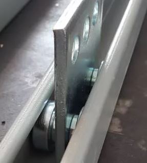

Did you mean these roller guides? They look like they would work perfect.
Roller Guide.JPG (19 KiB) Viewed 4437 times
[quote="domoarigato"]Hey there Phoenix. Funny you should ask about this, as I am finalizing the lift and getting ready to see if this flaming pile of crap that I cobbled together is going to work.. Just kidding, I have my fingers crossed.
It is a manual crank lift and basically a series of pulleys that all feed back to a central location where the crank is installed. One thing that I will say is that buying the roller guides like I did was completely unnecessary and ended up hurting more than helping. To be honest with you, I really like the idea that Icon posted in this thread and I believe made a separate thread about. His design / mechanism seems to be a LOT more clean than what I am going to end up with, and I would consider doing it if I were to ever do another.

Phoenix, due to the deviation's in the trailers trueness and the fairly tight tolerances of the trolleys, I was getting binding when I moved the bed up/down. I feel like a slider mechanism that could soak up the deviations could have worked in hind sight, but I ended up cutting out the rollers on one side to free it up. With the bed already pinned out in the stowed and sleeping positions, the trolleys just served as an unnecessary guide when travelling up/down IMO. I feel like it ended up complicating things and served as an overkill, when just a simple plate with no rollers would have fit the bill. Meh, if I didn't learn anything from my mistakes, I would probably know little to nothing at all.. :-D
