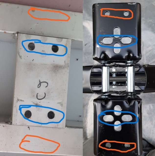

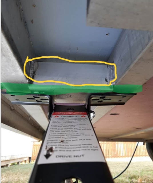

On my way home from a recent trip I hit something/ran over something that smashed one of my rear scissor jacks; so I am "getting the privilege" of having to replace it, ha! I asked the factory what model/brand the jacks were in hopes that I could just remove the old and pop in the new using the existing bracket. As Murphy's law would have it, this will not be the case even though I purchased the same brand/model jack. So.....
Need some help advice on how to properly do this. I know nothing about welding even though I have learned on this forum to make sure whomever works on my trailer needs to be good at welding aluminum (my trailer is all aluminum framing). My thoughts are to cut out the old bracket brace (marked in yellow) and replace with a thick piece of metal across the areas marked in green in this picture:
gallery/image.php?album_id=4863&image_id=172773
The reason for taking out the old brace is that it has 1/2" holes drilled thru it and of course Murphy has decided they are not going to line up with the new bracket holes. It looks like the holes circled in blue will not line up correctly with existing 1/2" holes. The holes in orange would go into the trailer frame if I needed extra bolts in the jack. The directions says to use 3/8" stainless steel self tapping screws. The original jack had 1/2" bolts that went all the way thru the part I want to cut out with nylon lock-nuts on the end of the 1/2"bolt.
gallery/image.php?album_id=4863&image_id=172772
I am not sure whether my idea is a good one or not but would like input on the best way to proceed with installing the new jack. I will have someone that knows what they are doing to do the cutting out/welding stuff.
