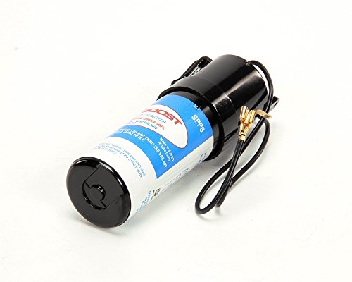

Classic signs of a hard start.. That is what the hard start capacitor does and for $11.00 I wouldn't waste any time until I eliminated that.
Most new air conditioners they advertise width a lower current startup have these built in. It takes 15 minutes to put in. Remove the cover and find the starter capacitor. This goes in parallel. If there are not terminals on the cap for this, the Supco has piggy back terminals built in. Easy as pie and I'm willing to bet it fixes your problem. I'll come put it in for you if you are concerned about the wiring part.

I am ordering this in a minute or two.
Supco SPP6, Relay Start Capacitor 120-288V.
Man that compressor draws a huge amount of juice when it kicks in and when its on its coldest it REALLY draws a lot but blows REALLY cold air when it works.
There it is done. 21.00 with shipping so it would be here Friday so I can install Saturday. will report back with results. :thumbsup: :beer:
