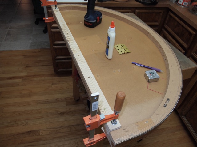

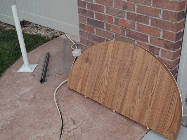

We've been hauling a not convenient table inside our CT. It's about 4' long and 28 or so inches wide. It is of a plastic top with folding legs bought at Home Depot. It worked well enough but was not really convenient to use. It had to be folded up and stored away either under our bunk beds or atop them. In travel it always seemed to slide out and off the bunk, crashing to the floor.
So of late we thought, hey, we need a folding table bolted/hinged to the wall that will fold up when not in use and fold down when we need it to work on our lap tops or when eating. We kicked around a lot of ideas such as a simple piece of plywood cut to the shape that could be bolted to the wall with hinges and a leg/or legs to hold it up in position when folded down for use. But then I got to thinking about tables we have owned in years past when we were much less affluent than we are now, not that we are all that affluent now. :oops: Simple kitchen tables that had a decent top but spindly legs. That's what we need, I thought.
So today we decided to hit the local thrift stores to see what we could find in the way of a simple round kitchen table top that we might be able to use for a folding CT table. My idea was to find a round small kitchen table that I could cut in half and use only one half of it bolted to the side wall of our CT using hinges so it could be folded up and out of the way while in transit and dropped down with a leg or two to support it when parked for the night. What we found today after visiting our fifth thrift store was this (see photos below). A small pull apart kitchen table with provisions for a leaf insert i.e., no cutting in half required because it was already so. We found it for $5 because it had a broken leg, which was perfect for our needs. I have no use for the legs as I will make my own. The first photo shows one half of the table as it originally came to us (the other half is in the house being modified). The second photo shows the mods I am making to one half of the table after the sliding leaf hardware was removed (and a cross brace glued and screwed to mount the hinges to).
My intent is that the table will fold up. I thought about installing it to fold down but then realized doing so would cover part of the ETrack hardware installed lower in the CT sidewall, something I will need open/available if I haul my Harley in the CT i.e., the ETrack provides the tie down points I will need to lock the HD in a parked position within the CT.
I will post more photos as I complete the installation of the table.
One half of the original table.
The other half as modified for hinge attachment to the CT side wall i.e., stiffener brace added.

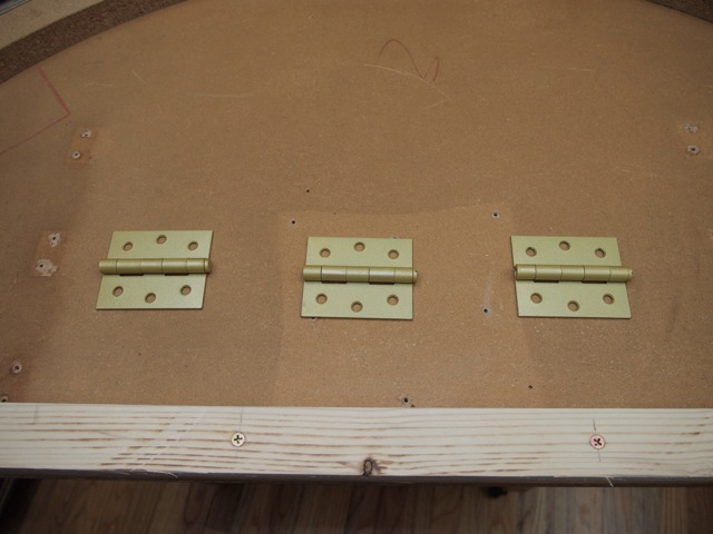

These are the hinges I intend to use to bolt the half table to the CT wall. Bought the hinges brand new from the local Habitat For Humanity Re-Use store, $1.50 for all three. Total cost of the new to us CT folding table now stands at $7.50. :applause:

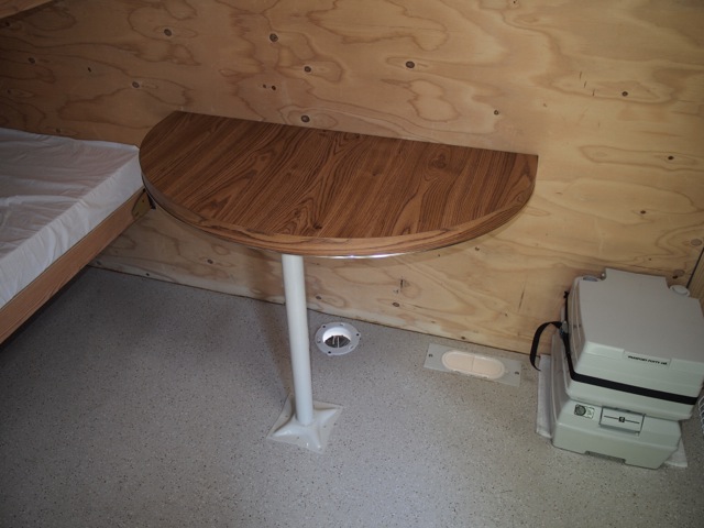

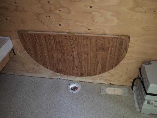

OK, got more done on our CT conversion today i.e., the folding table is installed and ready to go for our next outing.
Originally I intended to install it as a fold up table so I could still retain access to the ETrack I installed on the sidewall a couple years ago to support a full size queen bed, which didn't work out at all (you'll need to go back through our build thread to see and read about that and subsequent conversion to bunk beds). I left the ETrack in place figuring I could use it as tie down point should I want to take my Harley with us on an outing. Well it came to light that the table half used for our folding table is a lot heavier than I originally thought (it is made of pressed board with a Formica top and fascia, and as we know, pressed board is dense and heavy) and installing it in a fold up position would be a disaster waiting to happen. If I hit a big bump or traveled over rough road, which we do when boon docking, and if my design to hold it in the folded up position came loose, the table would flop down and rip the hinges right out of the 3/8" ply wood wall, which is the weak point of attachment. I decided better safe than sorry so changed the design to a fold down position. That change meant the ETrack was in the way and couldn't be used. Not a big deal. I can/will install tie down points embedded in the CT floor if I decide to take the HD along.
Be all that as it may, I installed the table today and it works great. Folds down and out of the way when traveling and is quite sturdy when in the up/in use position. In the photo below it is in the in use position. The support leg came with the table but I am using it in a reverse position, meaning the square foot you see on the CT floor was originally screwed to the underside of the table. It has a cone shaped/taper on the end that you can't see since it is under the table top that originally fit into a tripod set of legs with an opposite cone receptacle. I'll use it for now to support the table but will likely make something lighter to support the table (the table leg you see is fairly thick wall tube steel welded to the, also, heavy steel base plate). I can do with a lot less weight and still end up with a sturdy table. The second photo shows it folded for travel. A side benefit to the table install is Chrisiti can use it as a night stand since she gets the lower bunk. :applause:
Total cost for the folding table installed is about $10, that includes the cost of the table, the hinges, stiffener wood brace, glue, and screws. And I still have the other half of the table should I decide to install another folding table on the opposite wall of the CT. Tables aplenty. :lol:

Table in the in use position.
Table in the stow-away for travel position.

Postby roadinspector » Sun Apr 28, 2013 10:17 pm
Don,
:thumbsup: I like It! :applause: That was my original concept for a table till I came up with another idea that works better for us. I like the round. You have a good size table without it taking up too much room. I ended up getting RV removable table legs and recessed floor mount. Light weight and user friendly. My table is fee standing in the middle of the floor so I used two. The cost of one of my legs with two mounts was a few dollars more than your whole table setup.
