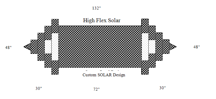

solar panel design.png (19.67 KiB) Viewed 4207 times
:thumbsup: :thumbsup: :thumbsup:

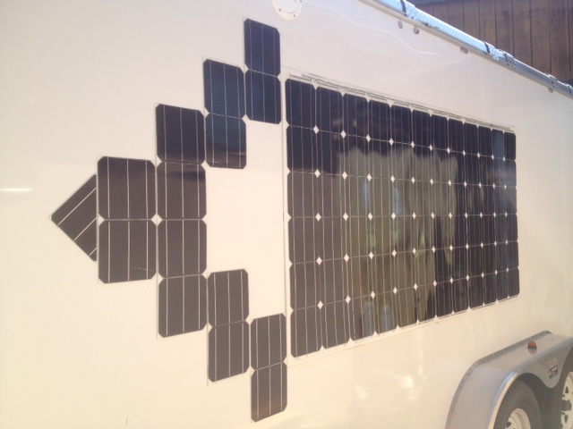

HFS photo.JPG (84.89 KiB) Viewed 4164 times
Custom designer solar here we come, you can never go to far "Over The Top"
stay tuned more coming.
:beer: :beer: :beer: :beer: :beer: :beer:
