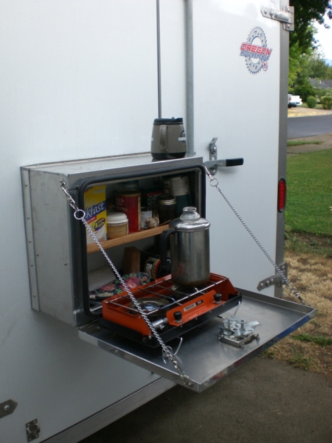

Questions answered:
The shiny aluminum tractor/trailer box on the back that opens to make a galley I cut so that it's half as deep now. The other half is the clothes storage box under the futon. The drawer has aluminum trim covering the cut edge, a cabinet handle and felt strips on the bottom for easy sliding. The half on the rear door that makes the galley is attached using aluminum angle, thru-bolted on the rear door. The back of the box is actually the face of the rear door.
Here's the website of the company where I got it:
http://www.800toolbox.com/underbody/underbody.htm $>
Mine was a "blem." Big discount.
Prem

Yes, those are choke chain doggy collars from the dollar store holding up the galley lid. :scratchthinking:

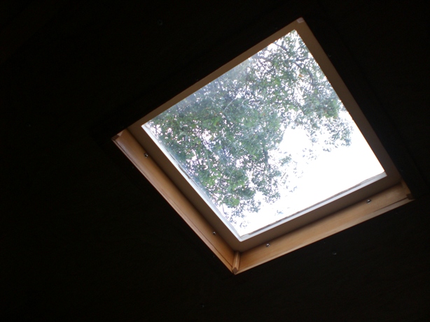

Acrylic, double-glazed skylight from ReStore, NIB for $20.
The view out the skylight laying in bed. (Stars at night.)

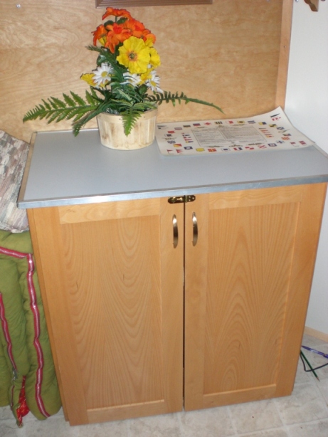

Postby digimark » Sun Aug 02, 2009 11:37 pm
(Re: Large Hadron Collider) Ah, so that's why it hasn't been lit yet -- it's gone missing in Prem's cupboard.
Prem -- is the cabinet home-made or store-bought, and any details available on source/cost? Depending on the dimensions, that looks like it might fit a spot in my trailer and buying one would be easier than building, for sure.

Postby Prem » Mon Aug 03, 2009 12:32 am
Digimark,
I got the cabinet doors at the local RESTORE (Habitat for Humanity), $5 each with hinges, brand new. I built the cabinet to fit. The Formica came from Habitat also.
