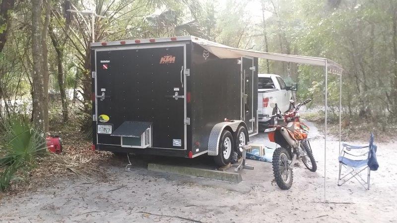

I will be cutting a hole in my ramp door and creating a spot for a 5500 BTU windows AC to replace the 7000BTU portable I have now. The portable does a good job (especially since I installed a 2 hose mod; however, this unit, although it runs on about 700W, it has a 2.5X surge current when the compressor kicks on. I cannot run it off my 1500W generator with a 2000W surge. When I turn it on, the generator chokes and the A/C kicks off line. The same generator has no problem with the 5500BTU window unit I have. I just need the generator for the AC since I am installing the solar panels to keep the battery charged. I will post some "after" pics this weekend. Following is how it looks now when in place:
Before: (after to come later this weekend)

Is the ramp door still going to be used as a ramp? How does the portion of the A/C that must live outside clear the ground?

Postby flboy » Thu May 22, 2014 8:40 pm
MtnDon wrote:Is the ramp door still going to be used as a ramp? How does the portion of the A/C that must live outside clear the ground?
Ramp will still be used as a ramp. I am going to make it so the AC can be removed for travel and then slid into place when the bikes are out. I will use some diamond plate aluminum to cover the opening when traveling. Hopefully I will get it dome this weekend. Will post pics.

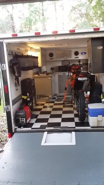

Postby flboy » Tue May 27, 2014 9:30 pm
Here it is. Got it done this weekend. I have a little more trim painting to do and I need to build a rollover cover for the inside (ramp) and put a ran dam over the cover hinges, but essentially done. I may paint the cover black. I don't know if I like that bright square on the back. :thinking:
I am here to tell you that a 5500 BTU window unit cools much better than a 7000 BTU portable and uses less power. Many factors to include the fact I just insulated the back door (I realized I forgot that when I removed the plywood, did all the rest when I built up the inside) and the fact that the condenser air ciruit for the window unit is not drawing outside air into the trailer. The humidity is much better controlled and etc.. Glad a I made the change.. and this will run on my small 1500W generator.
Live and learn. I bought the portable to start as it was minimal to install. It just needed a vent hole cut in the bottom. Then I modded it to make a two hose system.. but then that restricted the airflow and it still didn't gain much. Not too much lost however. I did sell it on Craigslist for about half what I paid for it after using it for 3 years. :thumbsup:

Postby flboy » Wed May 28, 2014 9:26 pm
Trimmed an painted it black. I think that makes it look much better. :thumbsup:
