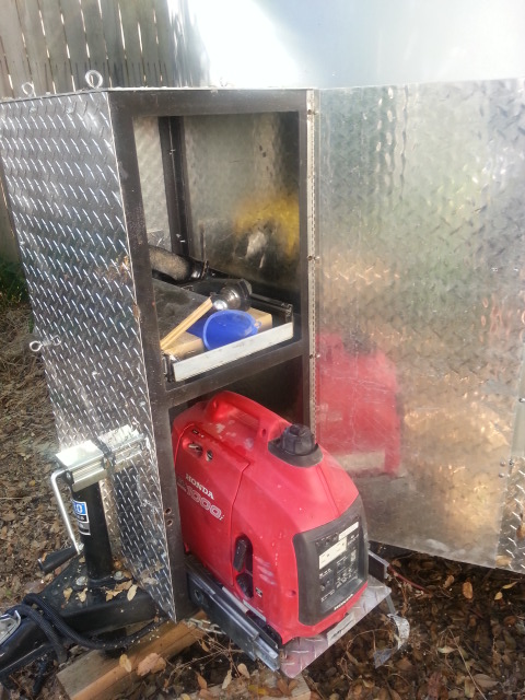

You wont be dissapointed in a Honda I have 2 1000is i used in tandem when i want to use my AC, i usually 1 generator when im camping, and i charge when I am driving between sites, or in the campground and they are quiet etc. I built a rack and cabinet on the front of my V-Nose with pull out drawers for the generators works real good and when im not using the other generator I use the top rack for storage.

I am sure I will like the Honda. Nice Cabinet you built. I am going to most likely just carry mine in the bed of the truck since I have a hard top locking cover.
