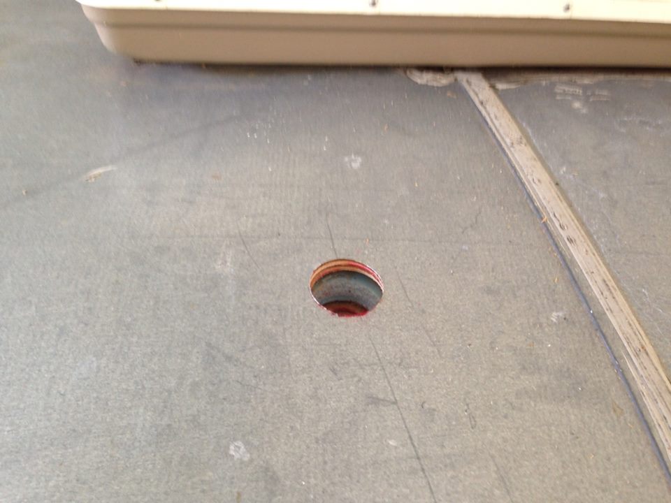

After a few years of spotty TV reception at best using a Winegard Hideaway antenna mounted on the front of my trailer, I decided it was time for an upgrade! After reading many reviews I decided to go with the new amplified Jack antenna. No worries of having to raise or lower it were one of the strong deciding factors along with the mostly great reviews. Putting another 2 1/4 inch hole in my roof is never an easy decision but I finally forced myself into it.

After figuring out how to run the cable internally though the ceiling to the antenna instead of externally which these antennas are designed for, I started mounting the actual antenna by carefully centering the directional control in the hole and attaching the cable to the antenna along with running the wire that supplies power to the amplifier through the notch shown here in the first picture.

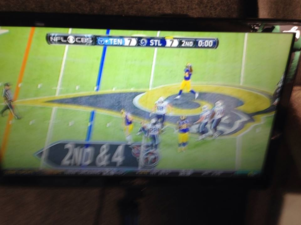

Finally after about an hour or so I had everything powered up and working. After scanning for channels I was now getting 8 channels here locally whereas I only had 4 with the old antenna. Only a few camping trips will tell whether this was a good upgrade or not but I feel I won't be too disappointed with this. I winterized the trailer last weekend but will hopefully get a few more trips in this winter since we almost always have some warm spells even in Jan and Feb. I have managed to get in 23 camping weekends so far this year.

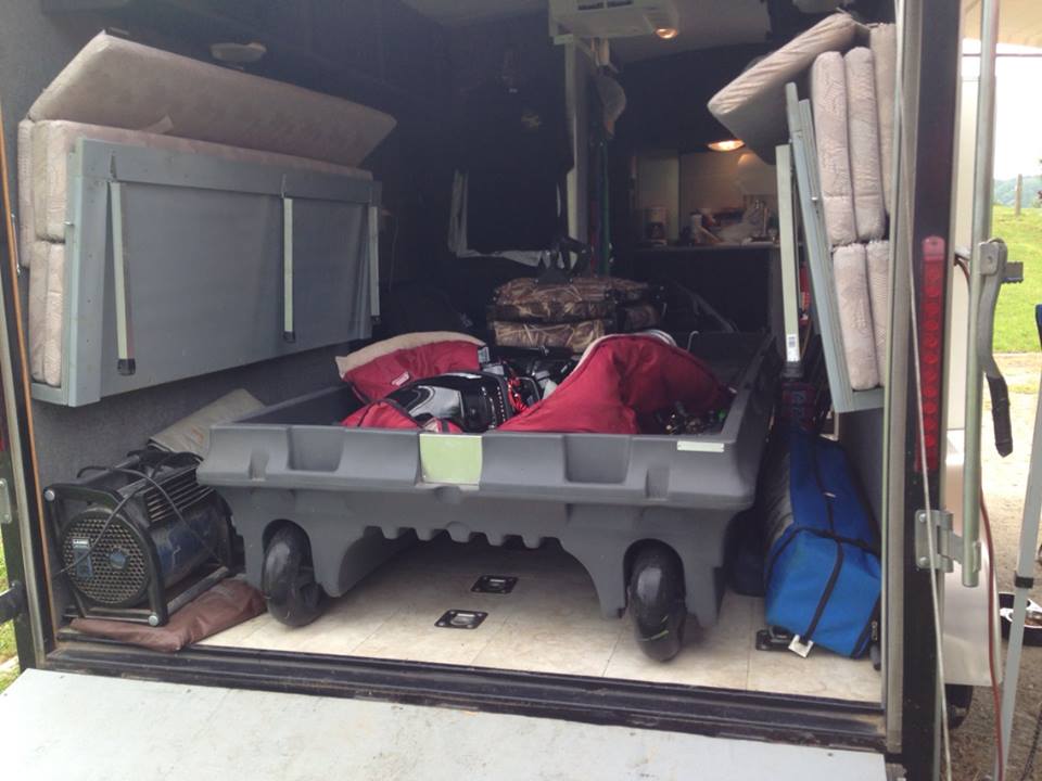

One thing that is not pictured in this thread is the fact that 2 tabletops make the center of the bed. I built one large one and a smaller one to finish filling in the center. The big one is stored on the back of the bathroom wall in slides of shorts that I built for it. The smaller one fits into another slide in the side wall and fits snug against the bathroom wall. Hard to explain but they have their on fitted storage and are completely out of the way when traveling and hauling motorcycles or boat or whatever.
