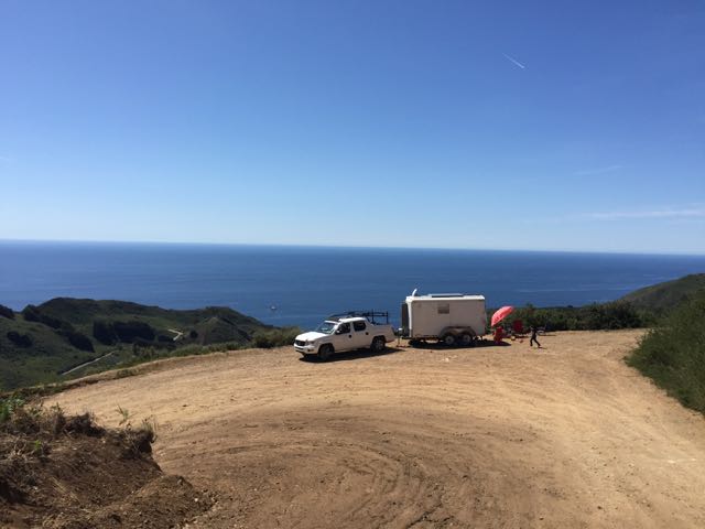

Postby dustboy » Mon Apr 13, 2015 10:08 pm
Spent the weekend boondocking on the Big Sur coast. Not a bad view, eh? Unfortunately this was as far as my little truck would tow, the really good campsites are a few miles further up. We had plenty of traction but without a low range transfer case, the hills were just too steep. Starting to think pretty seriously about a new TV.
All systems worked great, the new fridge was cold, and the new cooktop was hot. Guess I need to post some pics of those items.
The trip was nice but it was soured somewhat by drama with some nearby long-term campers vs. some locals that were trying to run them out. Normally the whole point of boondocking is to not have neighbors, but being spring break, even the boondocking spots were crowded on the coast.
