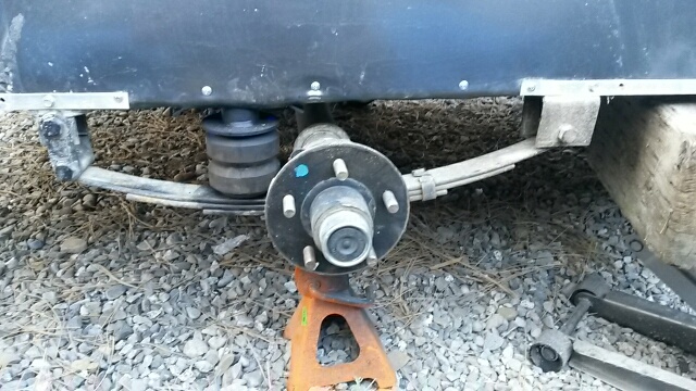

davidshourd wrote:Over the weekend took some time to fit up the rubber dampers
here is the rubber damper thing. made a couple angle brackets that then face weld to the inside of the trailer frame. (HATE welding upside down/overhead/under trailers!) we shall see how it rides once we get rolling again, it might be too tall for such a set up, if that is the case I have a plan to either get longer shackles to move the springs away from the damper or cut down the rubber damper. we shall see.
LATER POST
davidshourd wrote:the new suspension seemed to make a good difference on the rough roads
I like your suspension mod. I made my own version of the Timbren dampers, using Daystar bump stops. I like the way they work, and I also intend to go off-road with them. My thinking was that shocks have their limitations, but that a "tunable" positive-action cushion in the form of rubber (or in my case, progressively compressible polyurethane) would respond to all situations. You placed your Timbrens in slight compression upon installation; that's the key feature to make it respond to all road conditions (no slack, no delay).

I was surprised at the difference a big chunk of rubber made with the ride. prior to the installation little bumps would almost "chatter" the entire trailer up and down. with the timbren in there it seems to really smooth that out. and on larger bumpers the trailer does not just pop off the ground but seems to actually absorb it and keep "mostly" planted to the ground. I wanted to fit some shocks into the system too but I am rather content with just the Timbrens for the time being.
