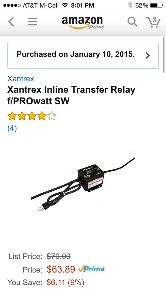

Postby abqlloyd » Sun Jan 25, 2015 10:05 pm
Hooked up the inverter and transfer switch. I went with the switch made for my inverter. All circuits will be either shore power or inverter. The switch is plug and play.

Re: 6x12 V-Nose Build
Postby abqlloyd » Sun Jan 25, 2015 10:07 pm
The outlet end goes to my QO box and breakers. I tested it by pulling the plug from the trailer and the inverter kicks in immediately.
Postby abqlloyd » Sun Jan 25, 2015 10:10 pm
After evaluating all the options, this seemed the easiest and cheapest. I still have the option of running one circuit dedicated inverter if I want. My QO box has two circuits. The transfer switch plugs into one of the outlets on the inverter. The other is not affected. I'm wired now so that both circuits are fed by the transfer switch but can make them independent although I'm not sure why I would need to.

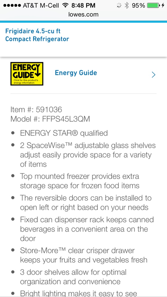

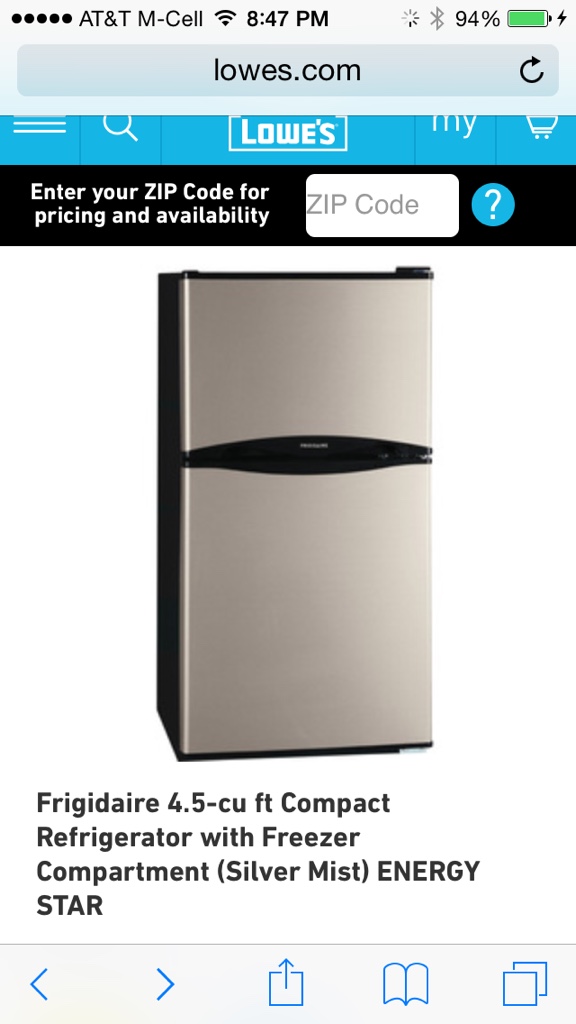

Postby abqlloyd » Wed Jan 28, 2015 10:48 pm
Lowe's:
abqlloyd

Postby abqlloyd » Wed Jan 28, 2015 10:55 pm
The label pegs it about one Kw hour per day. I'm seeing a little less but it is winter. The other day it used a total of 600 watts. I have two big panels, but am only using one right now. It will run this 24/7. When I'm back from camping I plan to just unplug it and open the door. I'll pre-chill before I head out.
There are pros and cons - but for $170 I'm not going to complain. I paid $800 for the ARB.
