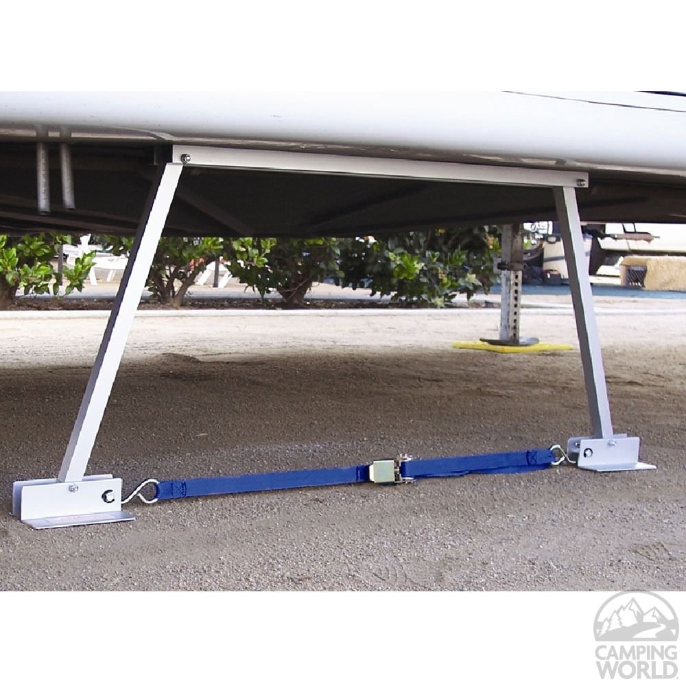

I could have had those snap up stabilizers installed when I ordered the trailer. I've been using these sometimes. One is a stabilizer that goes under the step. It does an amazing job of stabilizing one side of the camper so I usually use it. The other is one that actually does a great job but I usually don't bother to set it up. The camper will rock a little when you move in it but it won't tip backwards or forwards and I find that the slight movement isn't really that much of a problem. Often I don't use anything. These picts are from Amazon, not my trailer.

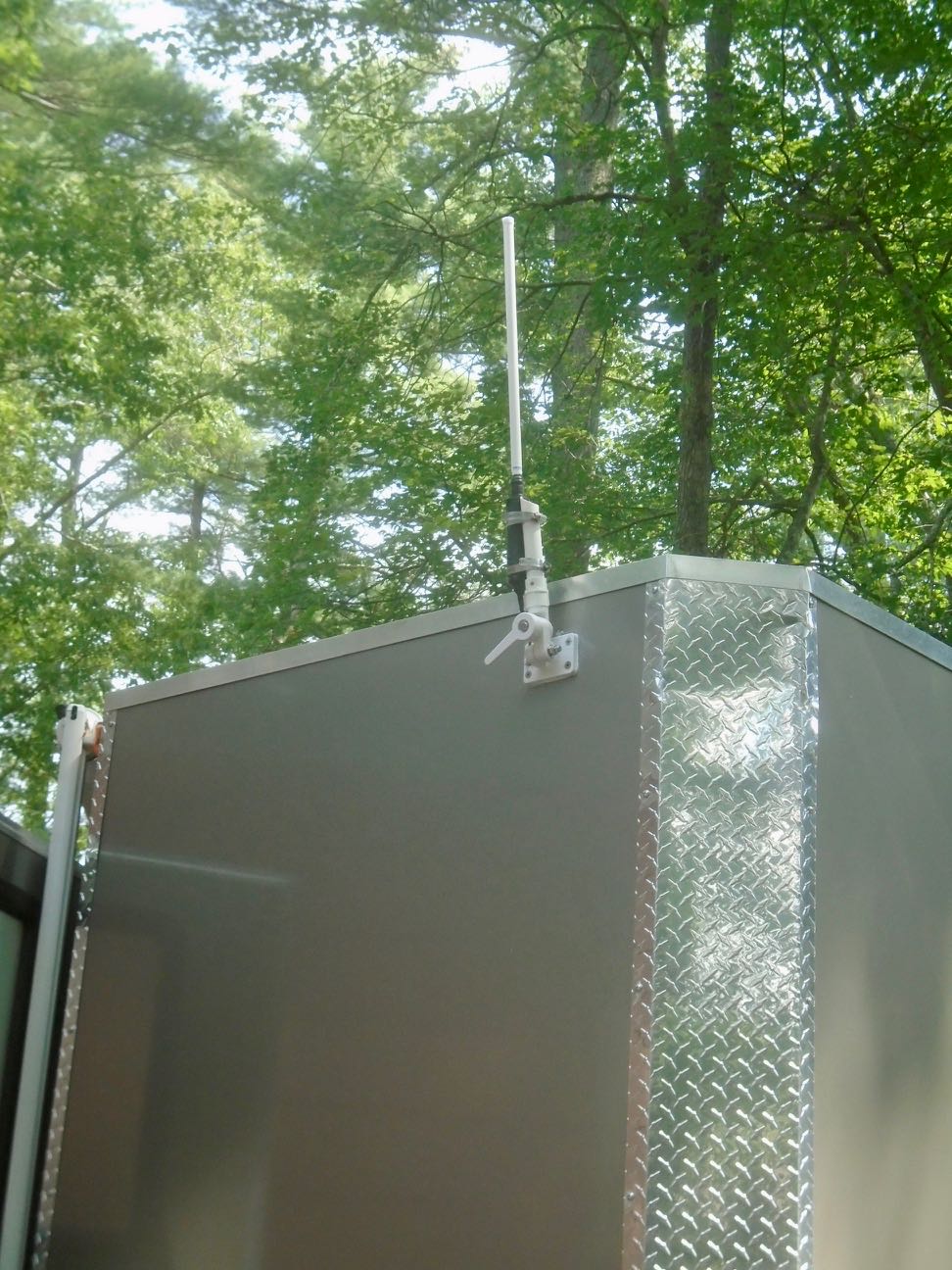

It's been awhile since I've posted to this conversion page. Since the last time we've put about another 15,000 miles on the camper.

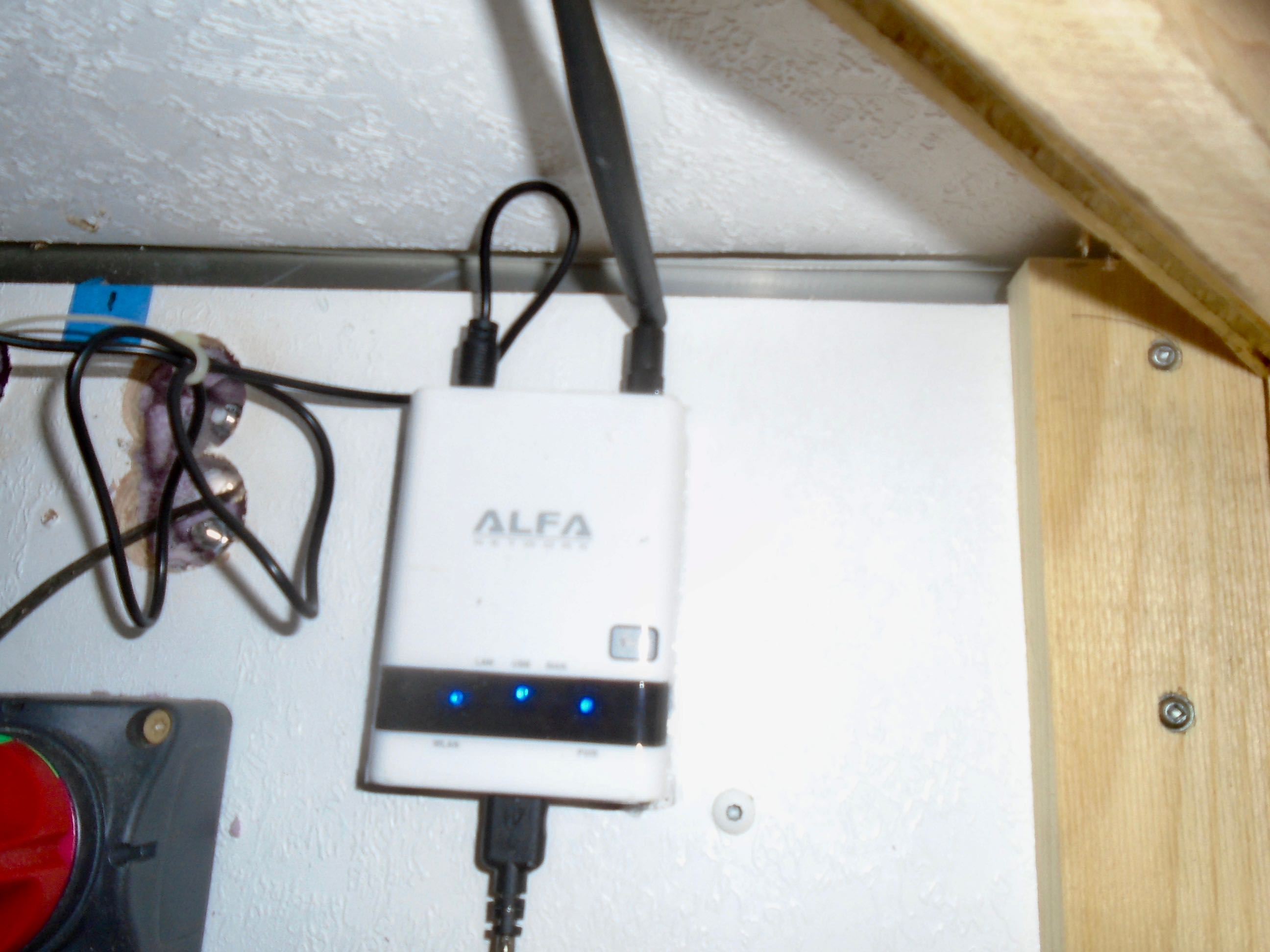

But, why I'm here. I've added a wireless hotspot to the camper. When we're at campgrounds they either don't have wireless or it's at the entrance and we're about a thousand feet from it. A lot of people go through their cell phones now but even though I worked IT before retiring I made the decision not to be 'one of those people'. You know, married to their phone. We do have a trakfone which sits in the truck, costs almost nothing, and does what we need it to when traveling.
So, to solve my wireless connection issue with the computer and ipad without breaking the bank, I purchased an ALFA system. For those who don't know there's an antenna mounted outside the trailer with electronics in it that detects signals then it sends it inside to a wireless router that out devices can connect to. The Antenna is about 15db gain. Testing it in the driveway I can see my sister's in house wireless router at about a half mile. Using your computer you pick an unlocked, or locked one if you have the password, and connect to it. The signal is as close as the router inside the camper after that.
Interestingly, we could never get a signal inside the camper as it's all aluminum. It acts like a Faraday cage. Now, we can't read out new router when outside the camper as it's inside of it.... But it works and works well
With the antenna up. I coated it in that dipping stuff to waterproof it.
The antenna folds down for traveling
The wireless router (hotspot) mounted inside the upper cabinet.

I used this kit, available online. Mine was from Amazon.
Alfa WiFi Camp Pro long range WiFi repeater kit R36/Tube-(U)N/AOA-2409-TF-Antenna
https://www.amazon.com/WiFi-Camp-Pro-re ... nna+camper
and the fold down antenna mount.
https://www.amazon.com/Shakespeare-4186 ... enna+mount
Total cost around $150+. I understand there are better units available but the cost really rises with most of the others. This one works just fine for us.
