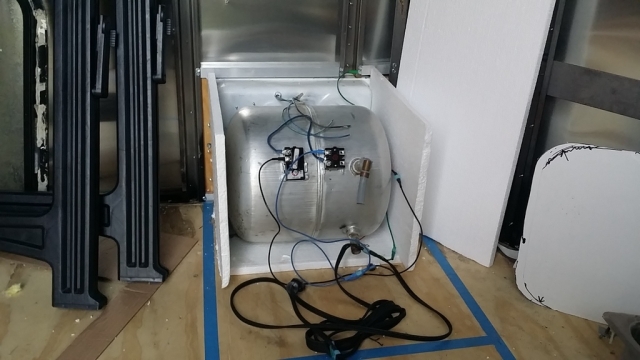

This is what I got done tonight after work. The water heater I restored from the donor camper was only propane. For $60 ON eBay , I bought a kit that came with a 600W element (inserts into the drain plug), the thermostat, the over overt temp (OT) shut off sensor, and all needed wiring. The sensor is suppose to mount on a flat surface, but the tank is rounded. I found a way to break the OT sensor and thermostat into two pieces by removing a bus bar, creating a longer jumper wire, and separating two metal tabs locking them together. The two pieces were short enough to make good contact with the thermal transducers in both individual pieces. Wiring is all set now for final hookup when I connect water and propane.
I have the 1 inch Styrofoam which I am building a box to surround the heater with and then I will blow in expanding foam. This will be well insulated. I'll takes some pics of that when done. I just need to tape up all the sides, makes some "keep out" covers for the thermostat and OT sensor, and then get a can of expanding foam.
I put the electric element in so I can save propane when I am connected to shore power. Also a backup if I run out of propane. It will run off the inverter or generator in that case.

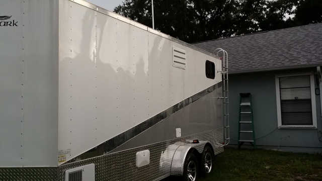

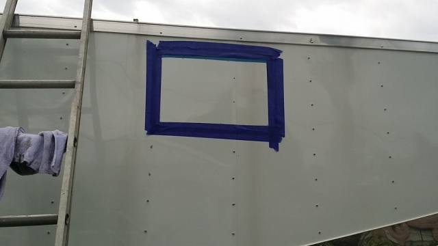

I got the AC Exhaust Vent in tonight. I still have to bolt, brace and seal it in. It started to rain so I had to knock it off for tonight. The intake vent will be on the roof right up top, then I build the AC into a cabinet on the inside at the same hieght as the vent. I Almost have all the outside cutting done and will be able to move inside and start the insulation and wiring! I want to get the AC in first so it will be cool in there while I am working! :thumbsup:

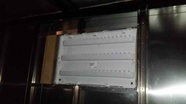

Following is the inside of the AC Vent. I have it all bolted in, braced, and sealed. I still have to install the roof intake vent and then figure out how I want to build the Air conditioner shelf and get it all to seal up well to isolate the intake and and output of the condenser fan when the window unit is slid into place on the shelf. I have a few ideas, but I never have done this before, so wish me luck! :NC
