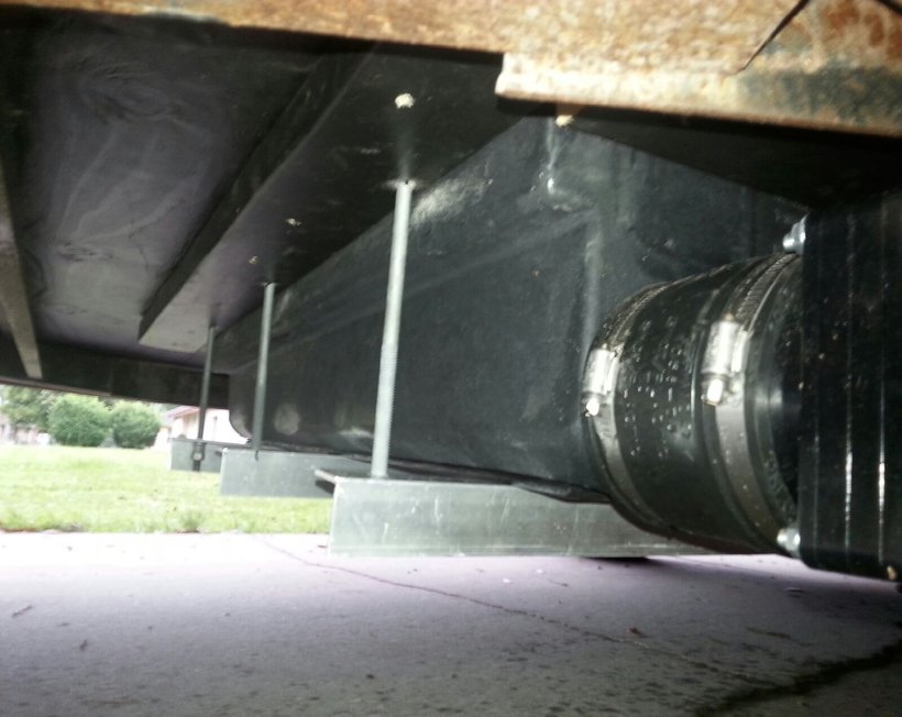

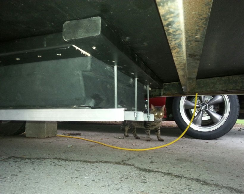

Got this done before the storms hit. More in a bit.
tank kitty resize.jpg (96.34 KiB) Viewed 3919 times
resize tank hang.jpg (72.92 KiB) Viewed 3919 times

Lastly, I did not finish that 2x4 tank stuff. The right side is hanging as I had to stop cause of the rain. Also I did not brace the back side because it is up against a small portion of cross frame flange and can not move at all unless the tank drops a quarter inch. Just info. I will silicone caulk and paint some more along the 2x4s. Any input is still welcome.

On the Tank, you'll have to explain what the 2*4's are for.. I am not understanding by the picture. I thought you had the carriage bolts through the floor of the trailer so the floor would be taking the load? Are the 2*4's just to prevent and lateral movement? If that's the purpose, then that would do it. I am not sure if the forces would be that significant in any case if you have the Carriage Bolts good and tight.. but I'd do the same just to be sure.

Just checking in on ya, Looks like you have been busy, but hey the tank looks MUCH better. She's not goin anywhere now.
