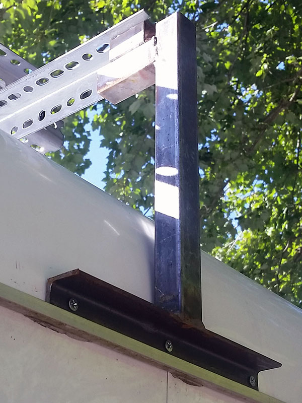

Roof rack did well, I will post pics asap. Basically I took angle and square tubing - welded the square to the angle and sat it in the drip channel. Lost a solar panel on the return trip since I didn't lash it down properly enough for the wind force of 70mph plus the extreme winds of the gorge (50+ gusts, together would be around at least 120mph against the panels... not counting the cars and semis passing me when I was going 70 - which is the speed limit) Got a new panel, its my fault for rushing the process, I just needed to anchor that side and it would have prevented that issue.

Hopefully my bad luck (and stupidity) will come to an end soon. It happens in 3's right? I tightened the power steering and thought it was still the squealer before we had left. Lesson learned :cry:
roof rack bracket.jpg (138.14 KiB) Viewed 4462 times
Pics of the roof rack bracket, I had to measure it by myself and came up an inch short when I changed my plans... If I redo this all I will get 1 1/4" perforated square tubing and cut and reweld the brackets better. But as it is now its solid and strong. I need to take it back down and paint it, again I was in a rush and didn't expect rain in the desert during summer

Postby hankaye » Thu Aug 17, 2017 9:59 pm
Mark959, Howdy;
Might consider welding some gussets to the area where the down tube attaches to the L bracket
that holds everything to the CT.
I'm kind of a belt-n-suspenders type when it comes to puttin' stuff together.
hank

Postby tylerjd » Thu Aug 17, 2017 10:10 pm
Mark959 wrote:Pics of the roof rack bracket, I had to measure it by myself and came up an inch short when I changed my plans... If I redo this all I will get 1 1/4" perforated square tubing and cut and reweld the brackets better. But as it is now its solid and strong. I need to take it back down and paint it, again I was in a rush and didn't expect rain in the desert during summer
Heh, yeah in many deserts that's just about the only time it does rain. Thanks for the pics, really cool to see how you did that. I have neither a welder, nor the skills to use one, nor the time (at the moment) to learn, so I'll have to go a less creative route. ><

Postby Mark959 » Mon Aug 21, 2017 1:05 pm
tylerjd wrote:Heh, yeah in many deserts that's just about the only time it does rain. Thanks for the pics, really cool to see how you did that. I have neither a welder, nor the skills to use one, nor the time (at the moment) to learn, so I'll have to go a less creative route. ><
You could do similar with bolts, and angle iron gusseting like Hankaye suggested
hankaye wrote:Mark959, Howdy;
hank
I was thinking the same, they are pretty solid but I will cut some angle iron and weld it in, thanks! That or maybe cut some plate into triangles... We'll see. It was a good test run!
