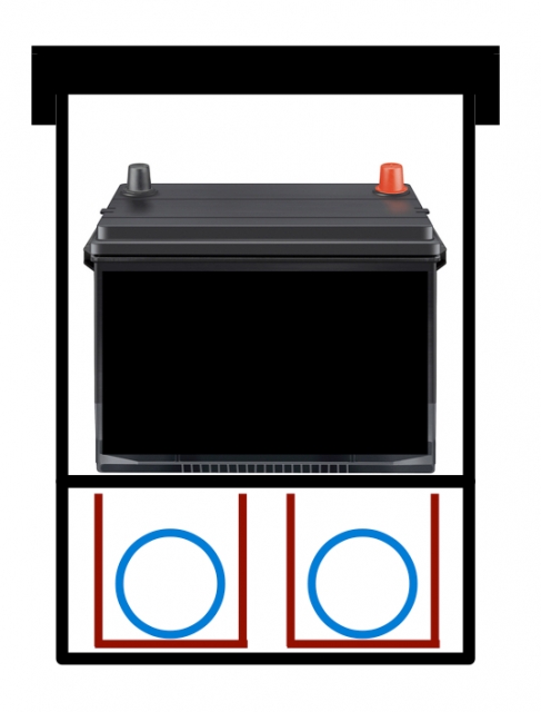

Postby Hader » Sat Nov 19, 2016 7:31 pm
This is what I'm thinking: 40"x20"x12" box.
(side view)

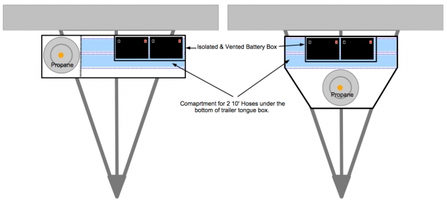

Postby Hader » Mon Nov 21, 2016 6:46 pm
This is what I came up with so far for the tongue box. I'm leaning toward the one on the right.
