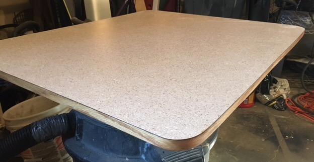

Postby fourbtgait » Sun Aug 13, 2017 7:48 pm
Odds and ends this afternoon. I took the dog jogging, became sunny, cool. Wifes input on kitchen hooks, fire extinguisher, paper towel holder. Hooks in 2 nose cupboards. Changed screws out on ice chest tray. Painted 4 storage area floors with almond rustoleum I had left over. Put a coar of varathane on edge trim of dinette table/bed support.

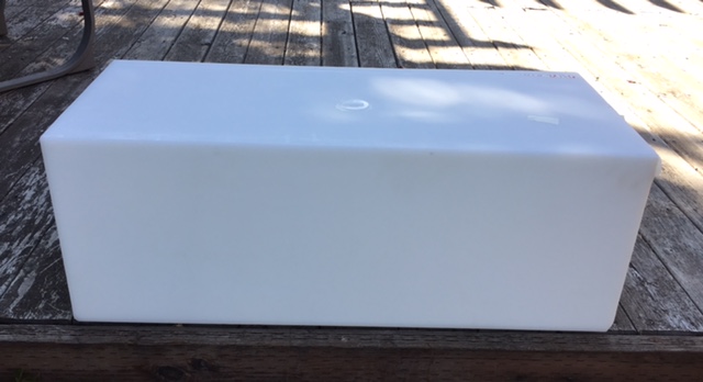

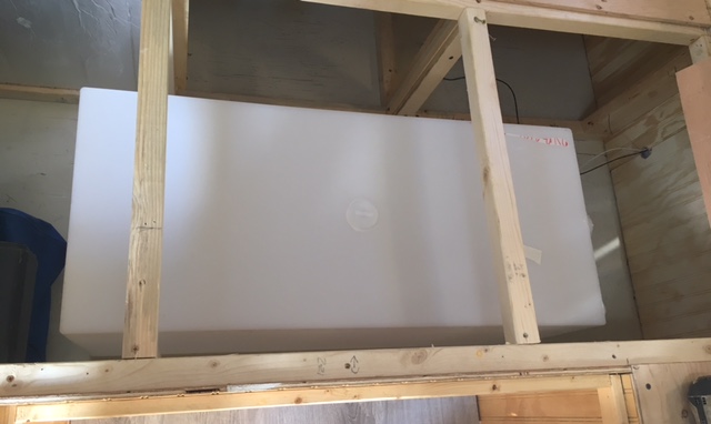

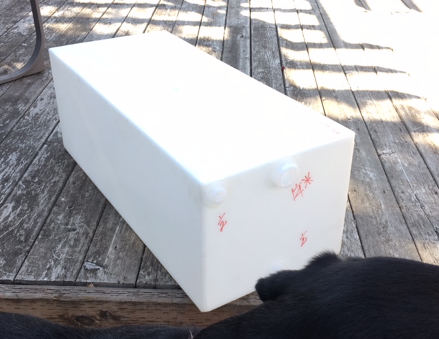

Postby fourbtgait » Wed Aug 16, 2017 6:38 pm
30 gallon water tank arrived.
It takes 2 mins to put 15 gallons in it from house pressure, our typical long weekend amount.
4 minutes for 30 gallons, a week plus trip.
After cleaning it, will set it on a 1/2" slope to fully drain it, hold it down with Simpson MST straps thru bolted.

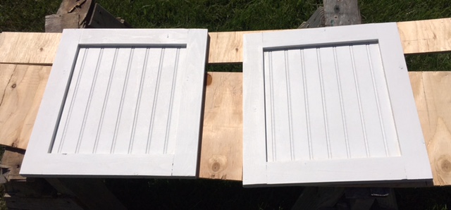

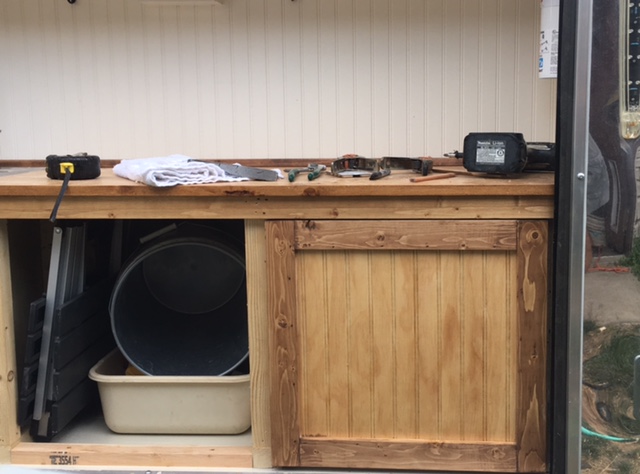

Postby fourbtgait » Fri Aug 18, 2017 9:40 pm
Basic doors started, nothing special. Quick, easy.
This one screws to the ice chest slede. There will be a mirror of it opposite side in the kitchen with 2 slab front drawers between. The stain helps to ground the lightness of the backsplash, upper cabinets.
Nose cupboard doors will be same style just painted cream.

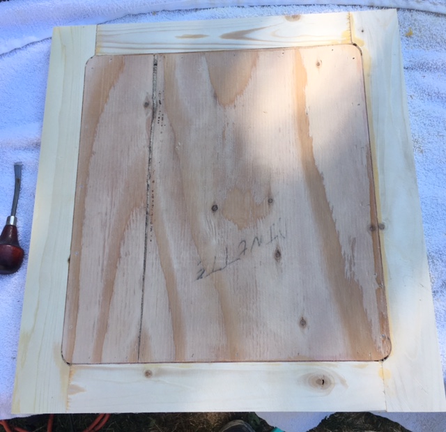

Postby fourbtgait » Sat Aug 19, 2017 9:05 am
featherliteCT1 wrote:I like your "basic" doors ... never having made any myself, looks like something I might be able to duplicate.
The outside stiles are rabbited for the beadboard to lay in it from the back, glued and brad nailed.
The stiles themselves are biscuit jointed, glued.
Some will say that the ply has to be free floating, in a groove, because of different expansion/contraction between ply and wood. But I have yet to see an issue.
Hidden hinges with a 1/2" overlay will be used. No decision on pulls.

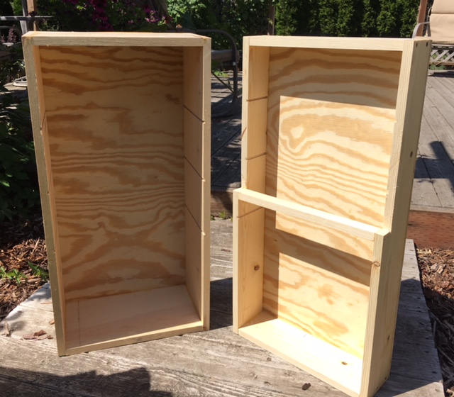

Postby fourbtgait » Mon Aug 21, 2017 6:17 pm
Had the day off work, no, not for the eclipse which was kind of disappointing here.
All doors glued up, 2 sanded and primed.
Drawer dimensions finalized, built, primed.
Drawers are 32" long, lower one is 9" deep, upper is 4 1/2" deep in the front, drops to 3 1/4" under the bed. Extra long because I had the drawer slides, plus they go into under bed area that was difficult to access.
