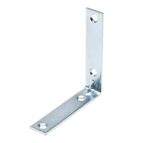

I just used a 3 inch metal bracket. I used these so I wouldn't have to nail into the side wall, however I found that it would have been better if I would attached some thin plywood underneath the brackets in order not to scrape the wood any.

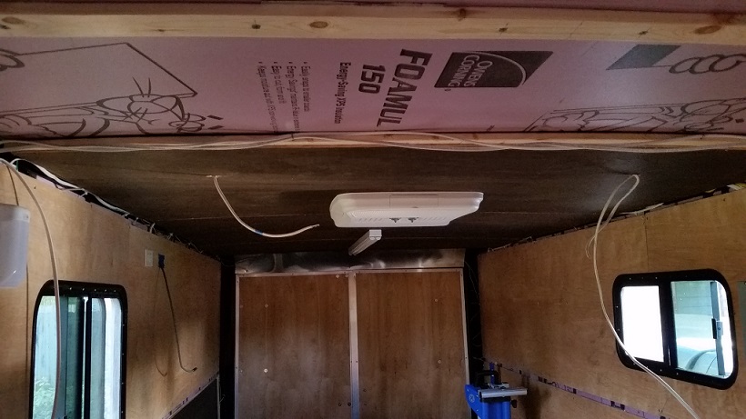

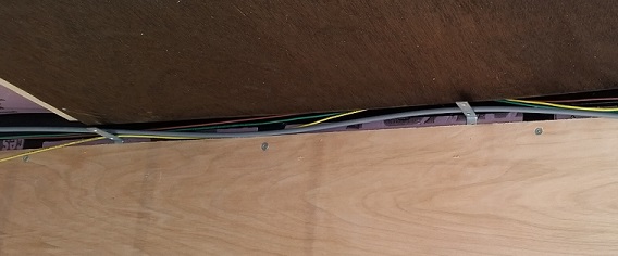

I've got three ceiling panels cut and installed along with the light wires running through. I've got another 78"x46" panel to install along with cutting for the vee up at the front of the trailer. We still will need to add some trim, dust and add a sealant of some sort on it when we have all the panels up, but it's looking more and more like a potential camper instead of a construction zone little by little.
Ceiling Progress.jpg (123.26 KiB) Viewed 4070 times

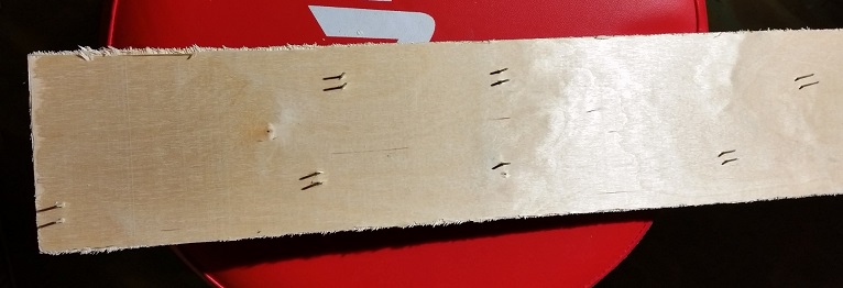

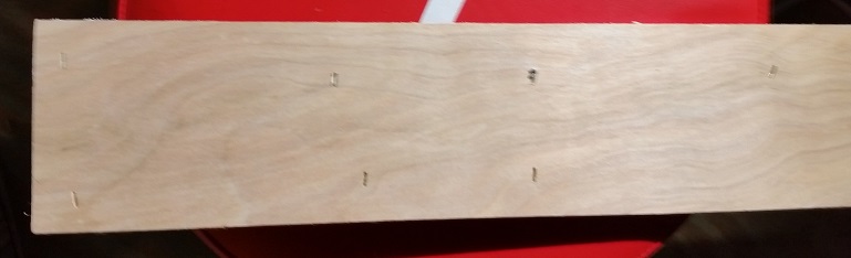

I've been prepping the wall trim to reinstall. I've tried hammering some of the staples out, but noticed that it made the entry whole a little bigger so I discarded that idea for just using a pair of wire cutters and snipping them off. Monotonous endeavor but it had to be done before reapplying.
Staples on Wall Trim (outside).jpg (56.21 KiB) Viewed 3868 times
Staples on Wall Trim (inside).jpg (77.41 KiB) Viewed 3868 times

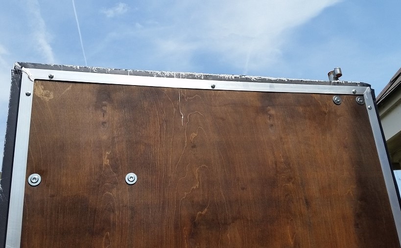

I made a big mess by using some caulking that a fella at Camping World recommended with out reading the particulars first myself. I was wanting to seal up the back doors with some caulking without any water being able to soak through. The stuff I got said not to use it on doors and windows. Unfortunately I didn't notice the message until installing afterwards... I needed the kind that won't pull off like stringie chewing gum. What a mess but I'll get it off and try to get the right stuff next time.

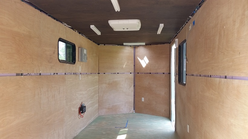

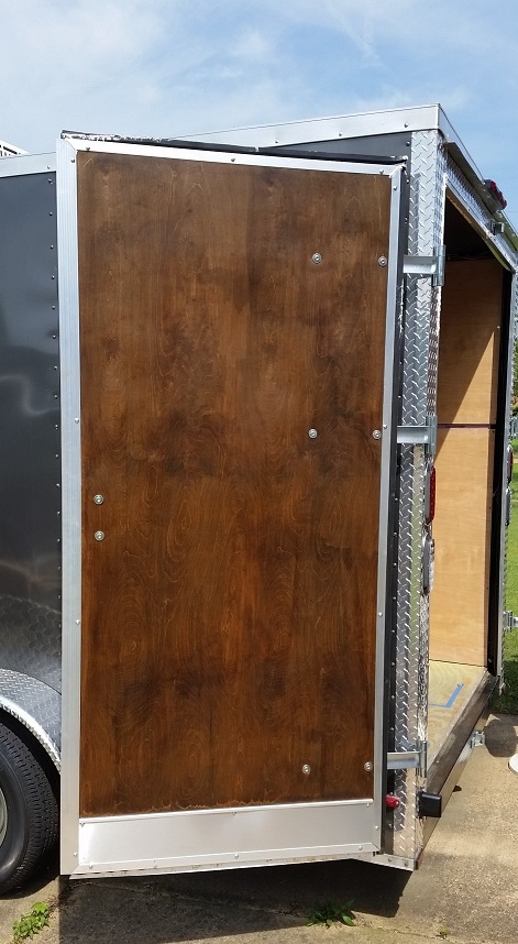

We've got everything stained and I've got my evening crew putting some Poly on the ceiling as I speak/type. I'm pleased with the stain on the ceiling back doors and base cabinets. I still have got to place some ceiling trim up over the gaps where the panels come together. The walls ought to look nice with some lighter paint on them.

Postby McDave » Sat Jun 09, 2018 5:13 pm
Hey FlyBye,
I really like the look of the stain on the doors. I may have to do that before I hang some artwork and a fire extinguisher on mine. So, about the staples. There is a tool for removing staples from upholstery and convertible tops that works great. It is a mini cats paw that has a screwdriver handle.. It pulls em out real fast and won't mar wood. I'd bet your local Ace Hardware has one. Or maybe you could fashion one from a medium sized flat blade. You'll need to put a "V" shaped groove in the center of the blade, and bevel so you can get under the staple, then put a slight bend in the blade for leverage like a cats paw. If I can locate mine I'll send a pic for reference.

Postby hankaye » Sat Jun 09, 2018 10:01 pm
FlyBye, Howdy;
Here's what McD is talking about, get or make one that will fit inside the 1/4" staples loop.
https://www.google.com/search?q=staple+ ... 17&bih=718
hank

Postby FlyBye » Sun Jun 10, 2018 1:31 pm
Hank & McDave,
I have already completed the "Staple Conundrum" with wire cutters. We have one of those nifty tools floating around here somewhere, but the staple itself was implanted so deep that even with the specialized tool there was going to be some undesirable hole enlargement. When I get the trim up, I'll just putty over it before painting. Thanks for the suggestion though.

Postby hankaye » Sun Jun 10, 2018 4:29 pm
flyby, Howdy;
Yah, know what you're talking about, mine were like that too. I just pried them off carefully
then tap-tap-tap with a hammer or the working end of the multi-tool then flip it over and pull
each one out and dump it in a jar with the rest of'em. Slow but methodical and you do get
all the bits-n-pieces that way. They sure do use a generous amount of air pressure when they
shoot them into the walls and I question if they used enough?
