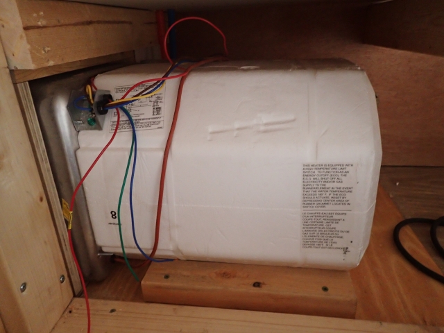

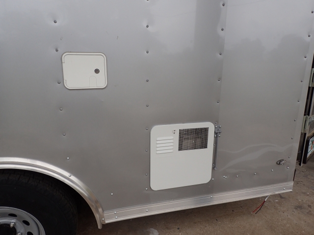

We have installed a suburban gas/elect. water heater. It is vented out the driver side behind the wheels.
Exterior view

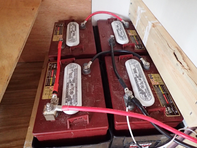

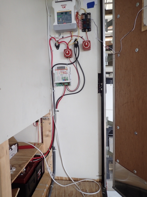

We have also installed 4 Trojan 105s. They are six volt batteries. We hooked them up in series parallel. This gives us 450 amp hours at 12 volts. You are supposed to keep the batteries above 50% so you have 225 amps of usable power without damaging your batteries. We moved these batteries from our boat.

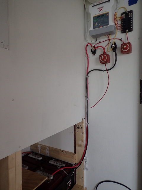

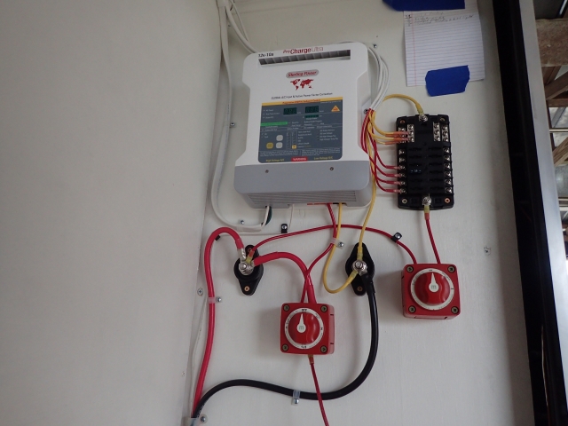

We have a sterling power smart charger for the batteries. We moved this charger from our boat. We are also installing a new battery to battery charger from sterling power to charge the batteries while we drive. The red 2 way switch below the charger is so we can switch from the a/c charger to the battery to battery charger. The red on/off switch below the charger to the right simply turns all the 12 volt power off to the trailer. The fuse panel to the right of the charger is for all the circuits in the trailer.
A view of the entire 12 volt system except for the battery to battery charger which will be hooked up below the other charger. The line just dangling from the 2 way switch will connect to the Battery to Battery charger.

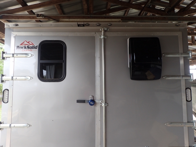

We put our Maxxair fan on the passenger side barn door. We put the 14 X 14 hole in perfect alignment with the window on the other door but the fan sits higher above the hole so it looks like we did not mount them even. With the fan on the barn door and the window in the utility wall not in direct alignment, the fan noise in the trailer living area is very low. And the fan is quit anyway.

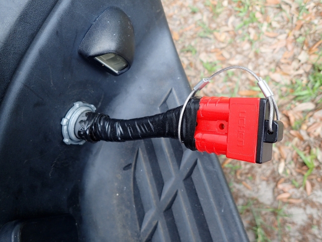

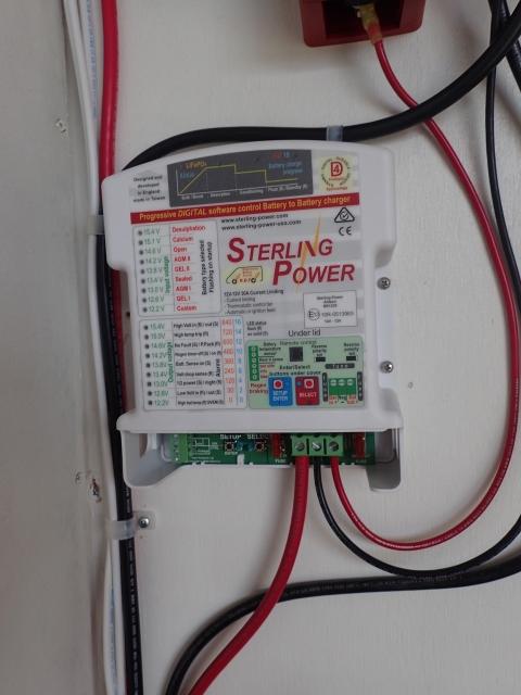

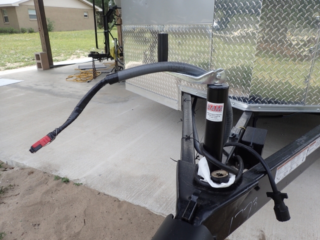

We also got our sterling power battery to battery charger installed. We had to run a #6 wire from the truck battery to the back of the truck. Also a wire from the trailer tongue to the rear of the trailer where the charger is located. We used 50 amp quick connects that folks use on their jeep and truck winches to hook the trailer line to the truck line. We put the wire in 1 inch flexible conduit just to be safe. The one bonus was that their was 1 inch holes already in the frame right where we needed them. They are up next to the floor of the trailer. We did have to enlarge them by 1/8".
The truck end of the connection
A picture of the conduit and wire in the utility room where it comes through the floor and up to the charger. Also a close up of the charger. This charger is capable of 30 amps at 12 volts. I have no idea how this thing works but it is hooked to our truck battery. We had out battery bank down to 90% charge and the truck just idling puts in 13.5 volts to the battery bank. It somehow fools the alternator into thinking the truck battery is low on charge. At least I think that is how it works. I am sure some others like flboy could look into this thing and understand it better. My reason for doing this is I wanted the truck to charge the batteries as we travel. I am sure there are cheaper ways to do this but this is a run the wire and hook it up, simple process.

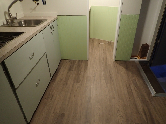

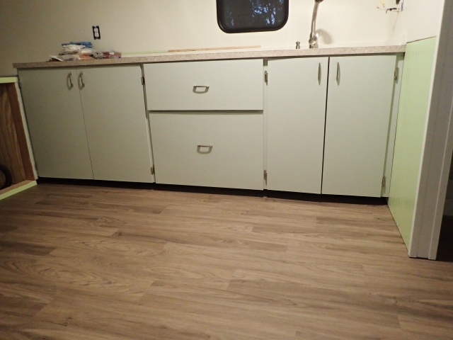

Don the Battery to Battery Charge was about $290. We will post how well it does on our trip. Today we installed the Allure Flooring vinyl planks in the trailer. All you need is a razor or box knife and a tape measure to put this stuff down. It sticks to itself and is very easy to put down. Here are a couple of pics.
This pic is with my back to the bed looking forward to the front of the trailer.

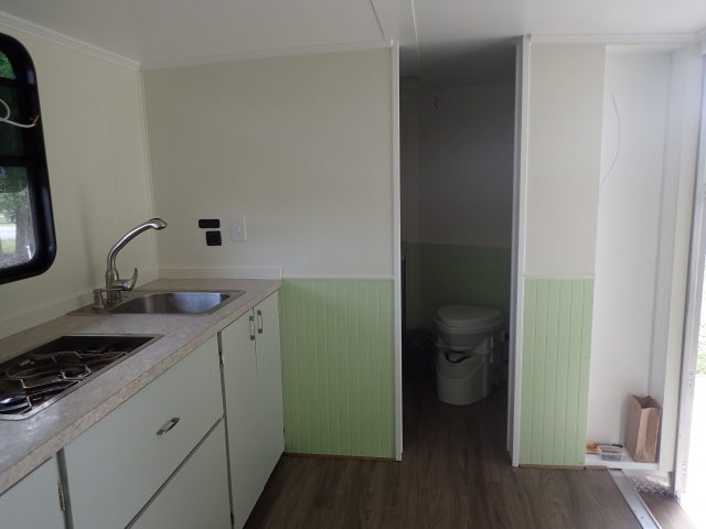

Trailer build 95% complete. Here are some quick pics. We are leaving tomorrow.

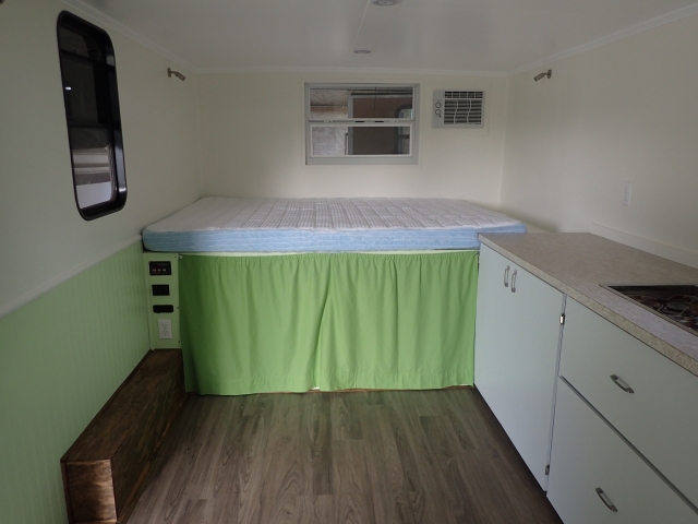

Looking forward from bed. Only thing missing is the curtain between living area and bathroom.

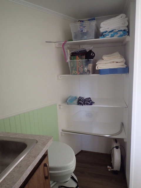

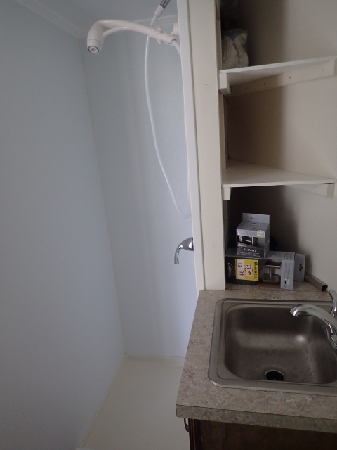

Standing in bathroom looking toward rear of trailer
In bathroom looking toward driver side
In bathroom looking toward passenger side

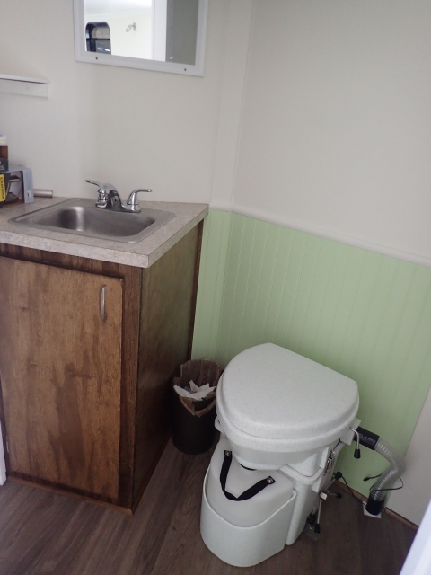

Picture of bathroom sink and composting toilet.

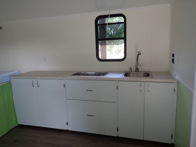

Kitchen cabinets
