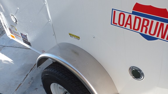

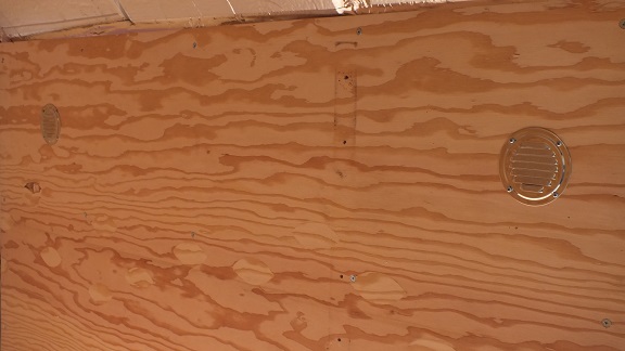

Postby CaleyAnn » Sun Feb 11, 2018 3:59 pm
My not being very experienced sometimes delays me a lot from trying something new. But I fought the urge to think more about things and went out and drilled those vent holes, and installed the vent covers. The outside covers still need the sealing around the edges.
I just took my time, drilling out the plywood holes first, and removing the wood disks. Then I drilled out the insulation, and pushed a bit to create a little indentation in the trailer skin. I removed the insulation. I then switched to a fairly small drill bit, and drilled a pilot hole. After that, I went outside with my hole cutter, and drilled into the pilot hole slowly, and kept the drill speed down while the hole saw went through the aluminum skin.
Gotta say that my expectations of disaster did not come true. Taking my time, and doing it all in small steps made perfect holes.
I taped the vent covers over the holes inside and out, then drilled screw pilot holes. Then all I had to do is carefully screw in the vent retaining screws, and the pictures are half of what I managed. I am happy with the results.
These vents are not large, only 80mm diameter, but I think that with two intake fans and two exhaust fans, I should get a fair amount of air movement and air exchange. The fact I have a teardrop door to install, that has a window that opens, and a Fantastic Fan desk version should at least keep me fairly cool during the hot months. Wish there was such a thing as a 500 BTU air conditioner. Wouldn't need anything larger because of the micro size of my camper trailer. I probably would purchase a generator that could handle that load.

Postby hankaye » Sun Feb 11, 2018 9:15 pm
CaleyAnn, Howdy;
Looks like you've done a fine job with the vents. I would like to offer a suggestion if I may,
Now I live in a desert too but it does rain here every once in awhile and dust relies on gravity
to help it locate itself in new spots. By re-positioning the openings you can help keep the
rain and most of the dust out of you walls. Just a thought that struck me when I was admiring
your handywork.
