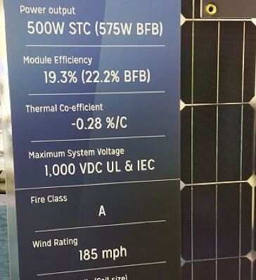

I spent this last week in LA at the 2015 Solar exhibit :D :D :D :D
Stay tuned the 500 watt panels, rated to 185 MPH are coming for your CT
1-500 watt solar.png (206.38 KiB) Viewed 4486 times
