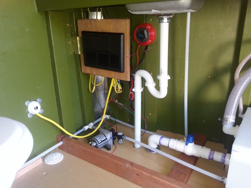

Thanks Hank. Here is an actual picture of how it is now.
May take a little work but it should fit but might be a problem. We shell see. It will be very close as I need to stay on the left of the sink drain pipe. :thinking: :thinking:

Postby hankaye » Wed Feb 01, 2017 1:45 pm
Tommy B. Howdy;
You could move the pump over a bit then with the judicious use of some elbows
and unions and remember the Accum. does not have to lay flat (with support), you
should find ample room for the Accum.
:roll: , ;) .
hank

Re: HALLMARK 6X12 CONVERSION
Postby flboy » Wed Feb 01, 2017 8:53 pm
Tommy B wrote:Thanks Hank. Here is an actual picture of how it is now.
Tommy, you could mount it on the head wall inline with the vertical pipe going to your sink faucet (from the pic it looks like you have a lot of room there) . Just screw it to the wall. It just needs to be on the cold side anywhere between the pump output and a faucet.

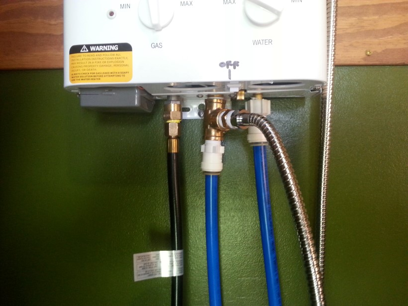

Postby Tommy B » Thu Feb 02, 2017 9:06 am
Hey Don,
I think it needs to be before the on demand heater also, and there for before the first T right after the pump. I say this because I notice a REALLY good bit of fluctuation in my hot water out put as I run the sink water. :thinking: This is some of the fine tuning I was referring too. A few issues after all.
I have tried various dial adjustments on that heater and still cant seem to dial it in to perfect. Either too cool or to hot. This may help some.
Anybody??
I really need to experiment with it in the driveway as water goes so fast when boon docking.

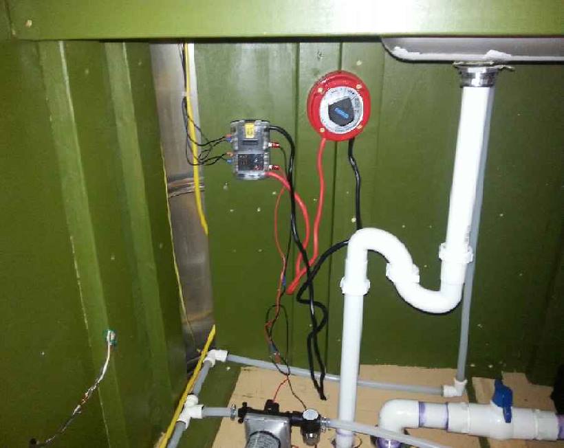

Postby Tommy B » Thu Feb 02, 2017 10:55 am
Jeeze you pretty sharp! That is a pic before I ran the hot water line. I did not even notice.
However it would seem that if the cold water tees off and runs up to the on demand water pump and then directly to the hot faucet, there would be no benefit for that line via the accum. :thinking: unless.....there would be back pressure back towards the tee and to the on demand heater as well as the toilet. But I figure only the out put end of the accum will ease the trouble, not both ends. :? Hahaaha.
Only way for sure is to nip it off right at the outlet side of that pump...I think....maybe.... :thinking:
Sorry you don't see the return line from the on demand. Let me look back and grab a previous pic..I will edit in a moment...but you get what I mean Don? Or anybody?
Postby hankaye » Thu Feb 02, 2017 11:11 am
Tommy B. Howdy;
As long as you have the Accum. installed before any outlet it should maintain a constant
pressure for the entire system from the exit from the pump to the furtherest faucet. Remember,
liquids do not compress, so the pressure will remain the same throughout ...
Postby Tommy B » Thu Feb 02, 2017 11:15 am
There if that helps some. Line on right is cold in coming, line on left is out going. I really think the accum must be before the T to provide relief to both the hot and cold. Right??? :thinking: :worship:
I see hank, that's seems to confirm it then. Before the T :applause: :beer:
Postby flboy » Thu Feb 02, 2017 1:14 pm
Tommy, the input an output is the same point if I understand the accumulator correctly. It is effectively just a T connection an you cant see the third side inside the tank. There is just a rubber bladder inside that holds about a 1/2 liter of water and compresses air between the bladder and plastic tank to create a back pressure.
Postby hankaye » Fri Feb 03, 2017 9:46 am
Tommy B. Howdy;
In the photo above my last post you can install the Accum. anywhere on either
side of the "T" that is shown to the Left of the pump. Installing it anywhere
along those 2 sections of PEX will pressurize the entire system except for the short
run from pump to Accum.
hank

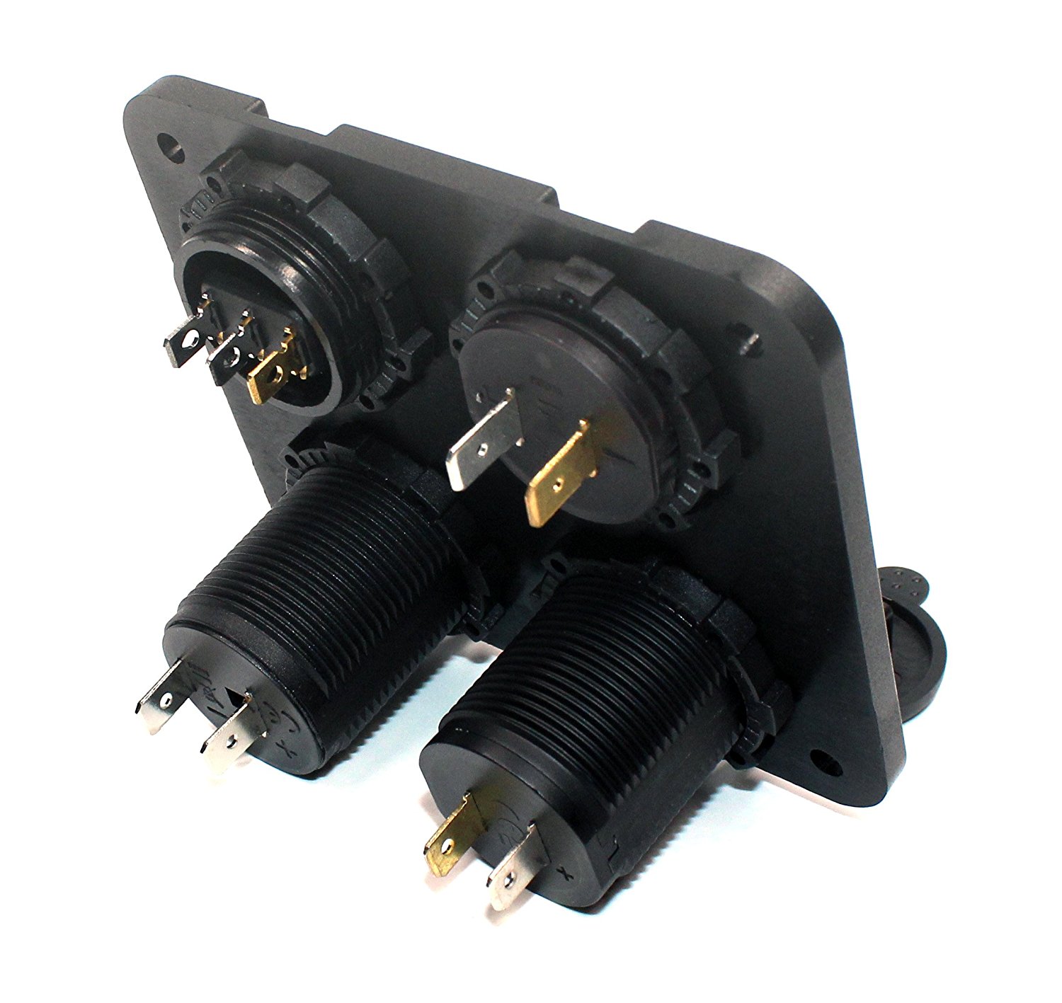

Postby Tommy B » Fri Feb 03, 2017 11:21 am
So while I am prepping for all this,
The 3 prong is for the on/off switch.
How do I wire this in so there is only two wires going to the Auxiliary buss? :thinking:
Postby flboy » Fri Feb 03, 2017 3:06 pm
Tommy, is that switch illuminated? If so, the copper side is ground and can be daisy chained with the other grounds. In that case, the other two terminals are the switch. Just make sure the battery side does not illuminate the switch when it is grounded. The light should only come on when switched.
The switched output is what you should daisy chain to the other + inputs.
If it doesn't make sense, bring it over and I'll wire it up for you so all you have to do is tie it in to your panel and ground.
Postby Tommy B » Fri Feb 03, 2017 3:58 pm
YES IT IS ILLUMANATED.
I don't know if that switch disconnects from the battery or just turns off the illumination. At any rate I probably will let you wire it up. Thanks. Should be here Monday. Could drop it off in your mail box after work one day. Pick it up when ever. Thank You.
