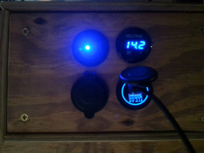

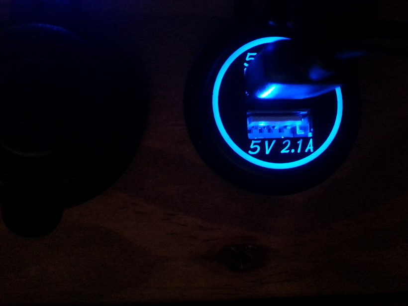

So the resting state of the battery unplugged from the house seems to be 12.9
Plugged in my dead phone and it dropped to 12.6 pretty quick. Also turned on two LED cabin lights and it remained at 12.6
Then I plugged in the house power and it jumped to that 14.2 that you see in the pic. Just Info. I feel all is well.
I don't know what the heck I did yesterday but both those USP ports work fine for charging the battery.

Postby flboy » Fri Feb 10, 2017 7:48 pm
Tommy, glad to hear the USB charger is fitting your cable now. :-) Now that you can measure your battery voltage, I'll share this with you which explains why you will see various voltages like 14.5 V and 13.5 volts when your charger is on. It is all normal and depends on the smart charger and the state of charge on your battery: I hope this helps. I got it from the internet so I didn't have to type it all in, but the literature usually comes with the smart charger.

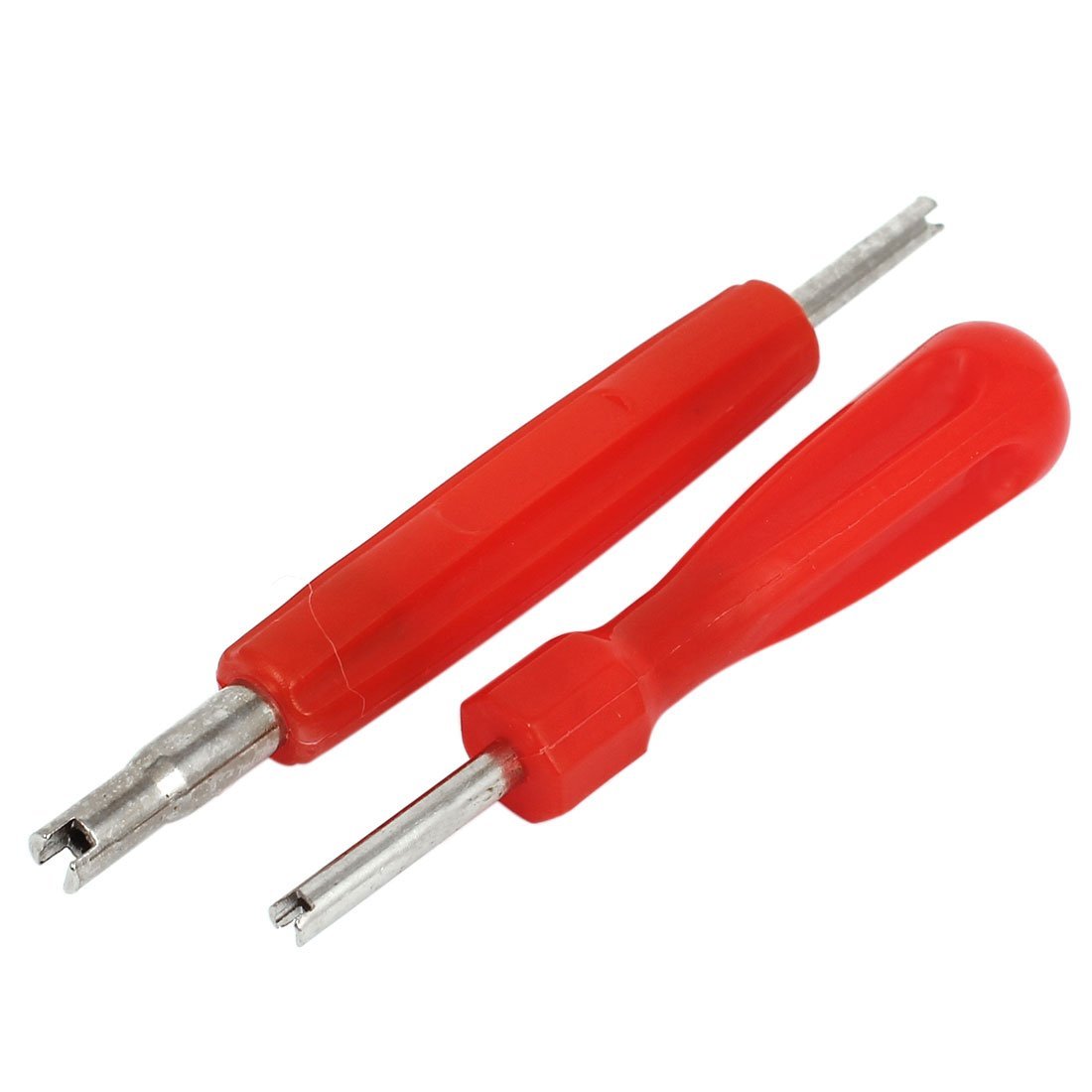

I will try to use the hose adapter I bought that can run the Coleman grill off a 20 lb tank. Would give you room to work with the bottle. The hose is like 3 feet long I think and has no regulator.
Also someone commented that they use a valve stem remover to unscrew the release valve half way. When propane starts to come out...tighten it up.
The valve stem remover should have a handle and a little length to it. I will Google around and see what I can find.

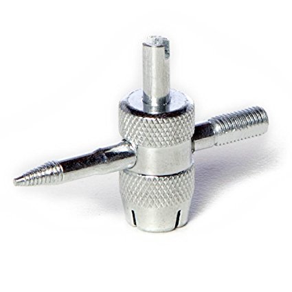

Postby Tommy B » Mon Feb 13, 2017 9:32 am
I actually need one of these for the boat trailer tire as one of the cores is leaking. I sprayed it with pb blaster and it is still leaking so I will kill to birds with one stone.

Postby flboy » Mon Feb 13, 2017 10:11 am
That 4 way tool does not fit in there. I have one and tried that last night. The other tool you showed may? I am going to try some needle nosed vice grip to hold the stem so I can easily pull it up like on the video. Let me know if you figure out how to back the valve out. That would be much easier.
