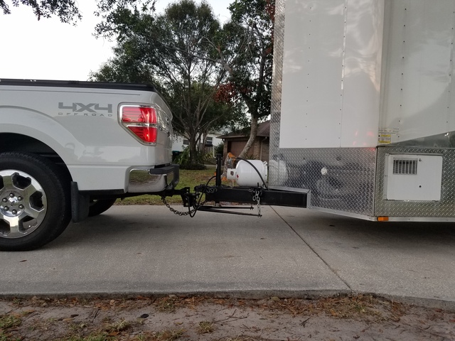

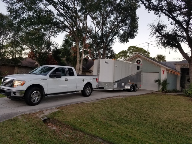

I got the hitch on. I followed the directions. The trailer looks level and same with the truck I think it is okay? Anyone know about load balancing hitches. What is the worst that can happen if I have it a little off? Shouldn't be any worse than without? Comments please. I am new at this one.
Trailer backed up fine into the driveway. That was one of the design criteria. I had to be able to get it into the driveway for loading and etc..

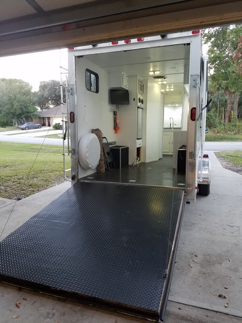

View into the back from the garage.. Will be able to load her up right from there. Yay! :) :)

The awning looks great as usual. The weight distributing hitch "looks" right. The only real way to tell is take your rig to a set of scales and have it weighed, see if it is balanced.

flboy, Howdy;
Just a few things this evening.
What McD said about the awning, I've seen some strange things in my life but the shapes that
the wind can create with a big sail and some "not up to the task" metal arms can win ya a spot
in the Guggenheim Museum. Whenever I travel with my 5th wheel I use some heavy zip ties to
keep the awning arms from trying to break dance along the roadways. Some folks have some
Velcro straps made to secure the arms.
If you can find a level area there in lumpy ole Fl. Un hook the trailer from the truck and measure
the height of your trucks wheel-wells (front & back), hook back up to the trailer and re measure
the wheel-wells. Is there a bunch of difference from the first set of measurements? Where is the
difference? Which direction is it, up or down? Same amount of up at one end and down at the other?
The set-up sheets should tell ya how to compensate if not then get on the phone and call'em. The
one I had for my old Tow (Equai-i-zer Hitch), was a different one from yours. Here's an informative article
to help ya get yer head wrapped around this stuff.
https://www.etrailer.com/faq-weightdistribution.aspx
Hope it helps.

Thanks Hank on the hitch information. I did measure the before and after. Less than an inch sag difference from load to no load. Prior to the hitch, it dropped near 2 inches. Wheel wells dropped about the same all the way around which I'd think means the weight is distributed correctly. I am anxious to see how it handles at highway speed. I have a anti-sway bar to install.. but I want to see what it is like before I install it. I'll have a road report later this week.

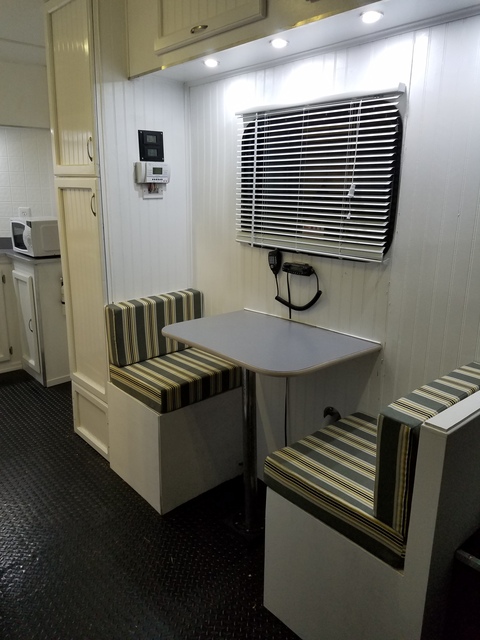

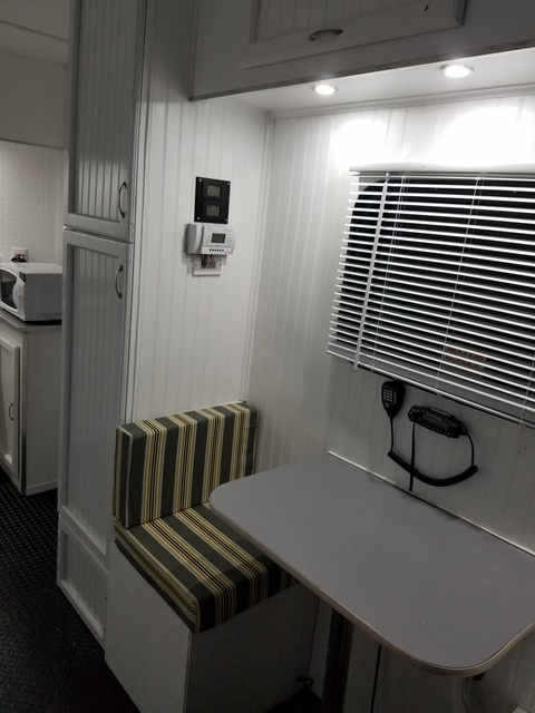

I picked up the cushions for one side of the dinette from my sister tonight. She is going to have the other side ready by Tuesday. She did a great job! The covers can be removed for cleaning when needed.
It is all coming together for the maiden voyage Thursday! I'll have to do the trim on the dinette seats when I get back. Don't need that done for the first trip. :thumbsup:

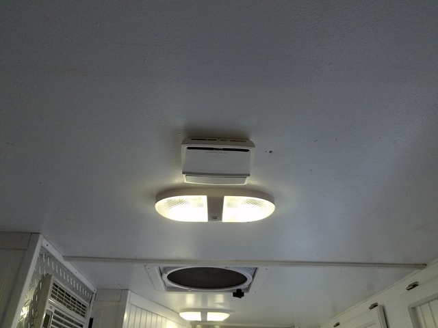

I Installed some safety items.... This is the First Alert Smoke and CO2 detector I bought back in September.

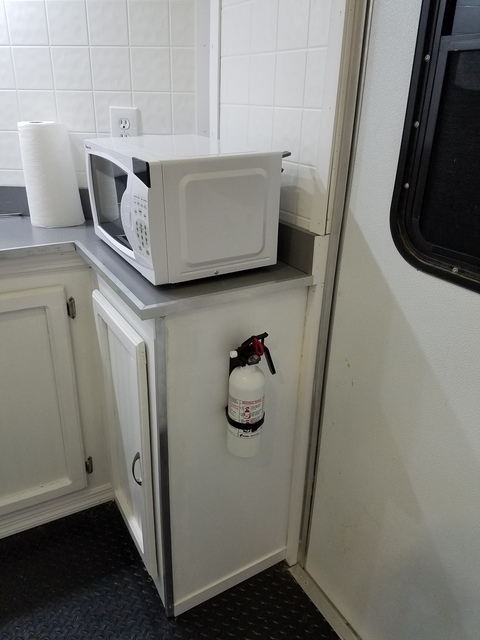

I mounted the Fire Extinguisher in a convenient place and close to where I am most likely to have a grease fire when I am cooking that bacon! :-)
Well.. this isn't for safety, but it is for emergencies. Need that TP Holder! I also put the bottom back in the cabinet to cover all that plumbing into the gray water tank and fresh water hookups. It needs a bottom in any case to make it usable for storage. It is not bolted down, so it is easily removed to access the plumbing below.
My sister delivered the last two cushions for the dinette. She did a great job upholstering the foam I cut. That 4" High Density foam may be overkill, but it sure is nice for sitting.

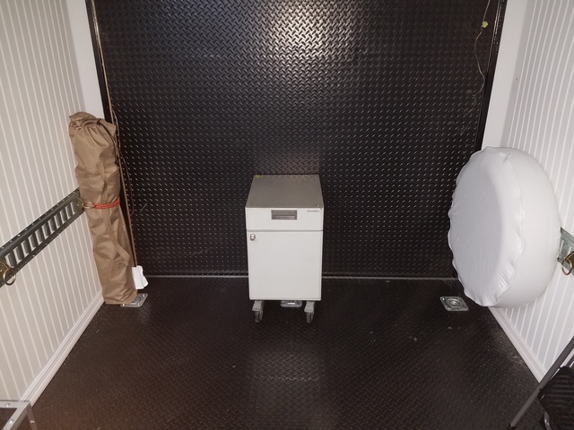

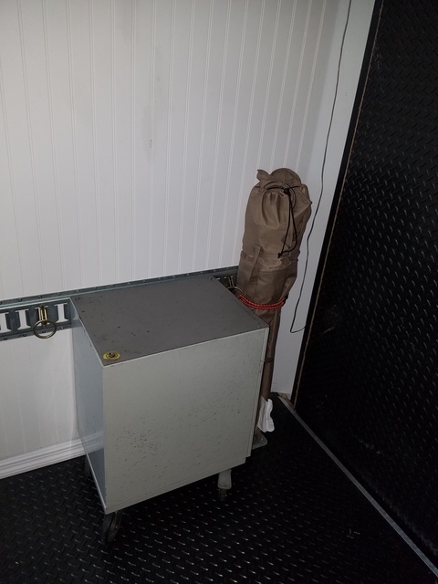

Lastly, I got this roll around cart for $5.00 at a surplus sale. I plan to keep all the Motorcycle tools, oils, etc.. in there and use it as an end table also when we are lounging around in back. It has castors, so I can roll it over to the eTrac, lock the wheels and secure it with a strap for travel. I may sand it down and paint it with a gray "hammered metal" finish in the near future.
Where the tool cart will be strapped for travel.

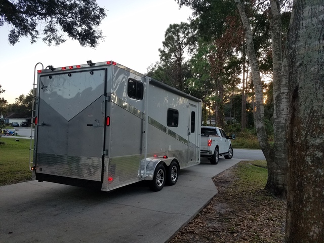

Loading up for the first trip. There a ton of little things to finish and the major task of building the loft bed, but it is done enough and everything is working well enough for a shake down trip. I have a Twin size double high blow up mattress I'll use on the floor in the back to sleep. It is plenty comfortable. I'll have some time between Christmas and New Years to fabricate the loft bed.
Fridge is on cooling down. I just need to fill the water tanks, add food and clothes tomorrow night and I'll leave from work Thursday. :-) We'll have some pics of the adventure!

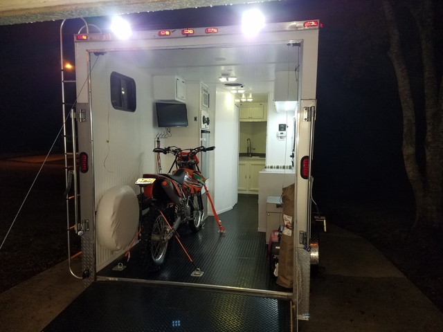

My wife came out while I was loading and snapped a few pics. She captured the moment.. looking in with the dirtbike perspective (one of my passions) and the satisfied look of getting to enjoy the fruits of many weekends and evening hours of hard work.
