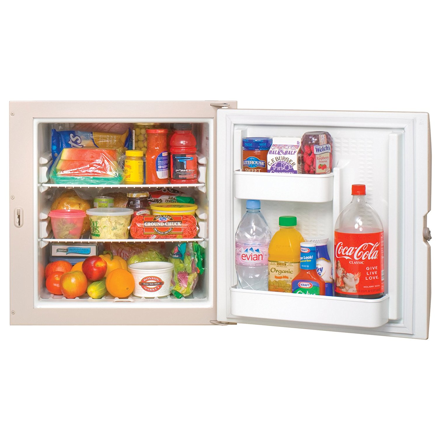

Postby Tommy B » Tue Feb 14, 2017 9:40 am
You know if I could figure out were to squeeze this in, my C.T, it would be perfect. :thinking:
Norcold 1 Door Refrigerator (3-Way AC/LP/DC, Right Hand Door) N260.3R 2.4 cu. ft.
• Adjustable, removable door bins Amps: 1.4 @ 120V AC Ship Wt 53 lbs. Cut Out Size: 21" H x 19-3/8" W x 24" D
This would be a huge deal. If not for the shower area it would go there. I would like it Eye level but would take what I could get if it would fit.
Are these good units? Three ways?
I saw portable ones. 12 volt dc but pricey and not LP gas. :thinking: :thinking:

Re: HALLMARK 6X12 CONVERSION

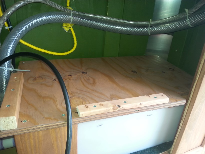

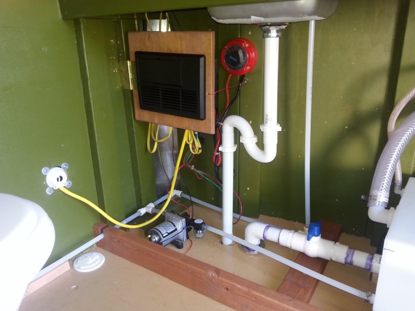

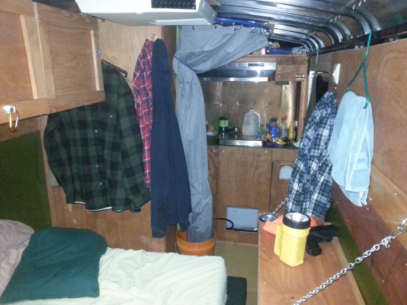

Postby Tommy B » Tue Feb 14, 2017 10:17 am
I may have it! With a few modifications. An extended shelve towards the drain pipe. May have to reroute the fill/vent tube some.
The only reason I did not consider this is the stove. Does the bottom basin of the stove top get too hot? Its at least hopeful but it still may not fit. Cant wait to measure it!
Filling coolers with ice and having to make ice runs is a real pain
Postby Tommy B » Tue Feb 14, 2017 10:25 am
I just read they need to be vented. Darn
Maybe a YETI cooler instead! :cry:
Postby McDave » Tue Feb 14, 2017 11:30 am
Hey Tommy,
I have a Norcold unit. I really like it. Model # DE-251E It is 12v and 120v only, no lp. However, there are advantages and disadvantages to each type. This 2-way AC/DC frig. uses a compressor and Freon, like your standard home unit or air cond.
3-way reefers work through the "absorption" system, which uses boiling ammonia vapors to absorb and remove heat.
When a 3-way is used on 12v or 120v, the voltage is sent to heaters to boil the ammonia. Also, 3-ways ALWAYS need 12v available to open the LP solenoid valve. You will also notice there is no "freezer" area in that unit. 3-ways MUST be vented to the outside.
My 2-way unit has a 40 watt compressor or to put it another way 3.3 amps at 12v or 0.33 amps at 120v when running. No outside vent required. She runs for 1/10 or 1min on, 10min off. So, at 12v consumption = 3.3a per hr /10 or .33amps per hr consumed. At 120v, .33a per hr/10= .033 amps consumed. At .33a, (12v) that is 8amp hrs/24hr day. A 100 amp deep cycle will power this unit for 6 days before reaching 50% discharge. It also has a freezer and makes ice, keeps ice cream and other frozen goods frozen.
You will notice the amperage difference at 120v. 3-way = 1.4a.... 2-way = .33a.... That's a 4 to 1 difference. This is due to the fact that the most inefficient way to produce heat (required to boil ammonia) is via electricity. 2-way Compressors are pumps, heat pumps that pump the heat outside the fridg. Also, 3-way cannot use lp when in transit.
I got this unit off E-bay for 170.00 shipped and it was brand new, taken out of a boat. I'm only giving you these numbers as a reference. It won't be long before an engineer pipes in to discount this info, but then again, engineer's fly paper airplanes. Pilots, ... well you know the rest...
