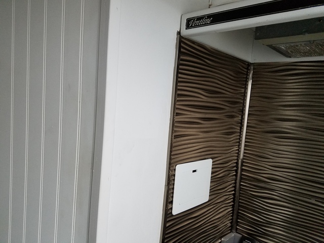

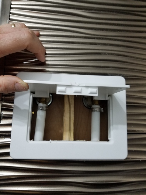

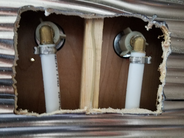

I found and fixed my water leak today. It was not where I expected it since I didn't see the water coming down pex line and dripping where I though it should. The shower connections behind the wall had a slight drip on both sides. The surface tension of the pex line allowed the water to come down the backside of the pipes and it hit the edge of the shower pan coming down and transferred there to drip under the shower. It did not come all the way down where I expected to see it at the connection point.
In any case, I had to cut into the wall to fix the connections. It is something I'd have to do someday anyhow if the shower faucet ever needs to be replaced.
The drip... you can see it. Was enough to cause some puddling overnight and I'd periodically hear the pump turn on for about a second.
I put in an access panel. That was the best I could do to cover the hole without buying a new piece of backslash... But now I can inspect anytime I want.
I don't look too bad... if I get tired of it... I could buy another piece of backslash... but I want to keep an eye on it in for a while in any case.

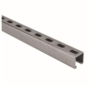

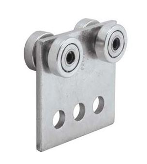

Over the next few days and before the festivities begin, I plan on building the loft bed. I have finally settled on the hardware I am going to use for the track and trolley system. I won't have the trolleys until Thursday (just ordered from Amazon) ... but I should have everything ready to bolt up by then.
These Trolleys will ride inside the 1 5/8" slotted strut channel I got at Home Depot. There will be 4 vertical channels 3.5 ft. long coming down from the ceiling for each corner of the bed. The trolleys will just be for guiding the bed up and down... I'll have a rail in the down position on both sides for the bed to rest on. I imagine the bed will travel easily with these trolleys. They were a little pricey.. but they are a key part of the system to prevent binding and etc.. I couldn't think of a less expensive way..
I'll figure out the gas strut positioning once everything is in place. I am also dreaming up a cable and pulley system I can use with a cheap Harbor Freight Electric ATV Winch. I'll try the gas struts first since I already have them, but it would be cool just to hit a switch to deploy the bed.
I'll take lots of in process pics so anyone interested can duplicate. Not sure how this is going to turn out. This is another first for me.
