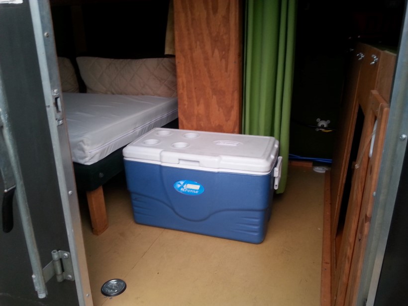

Well If I can get over it being here when the bed is down, I can get that 61L cooler. If your going to do it...do it right the first time. The genny can be stored by the bed up or down. When its time to shower just move the cooler some. It could function as a seat there to.
Just two hang ups.
have to install a 12 volt outlet over there. This one will go to the last spot left in the power center and have its on fuse. I can thicken the wire if I need to now.
There is a tie down there that will be underneath the cooler if I cant move it towards the door a bit. It would be rocky. But I think I can it just will not be flush against the wall by 4 inches or so.
This way there will NEVER be a need for ice. Can always restock with beer as you use them god forbid a case or two doesn't hold me over on the initial stocking. ahemm, :shock: Daddy likes his beer. :lol:

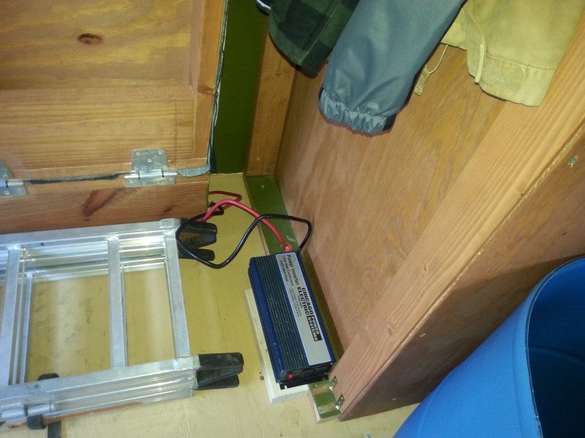

Hey I found this flush mount to the wall set up. Will save me a lot of work. In addition to plugging in the cooler, I could hook up a radio or fan here also.
Ignore the power inverter its an old pic.
•1 x 15A AGC Fuse is included.
Would I need this in line fuse if I run directly to my power center and I could install a 15 amp blade fuse there. Right?
And call it lazy or smart but rather than run wire up to ceiling and over to the wall and then forward and then down the front which requires me to remove a brass panel..whew...
I will stay low and go through the wall there and hide the wire in pex tubing. Zip tie it to the other blue pex tubing. :thinking:

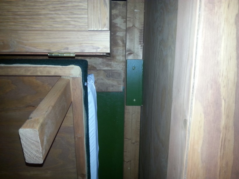

Postby Tommy B » Fri Feb 17, 2017 3:08 pm

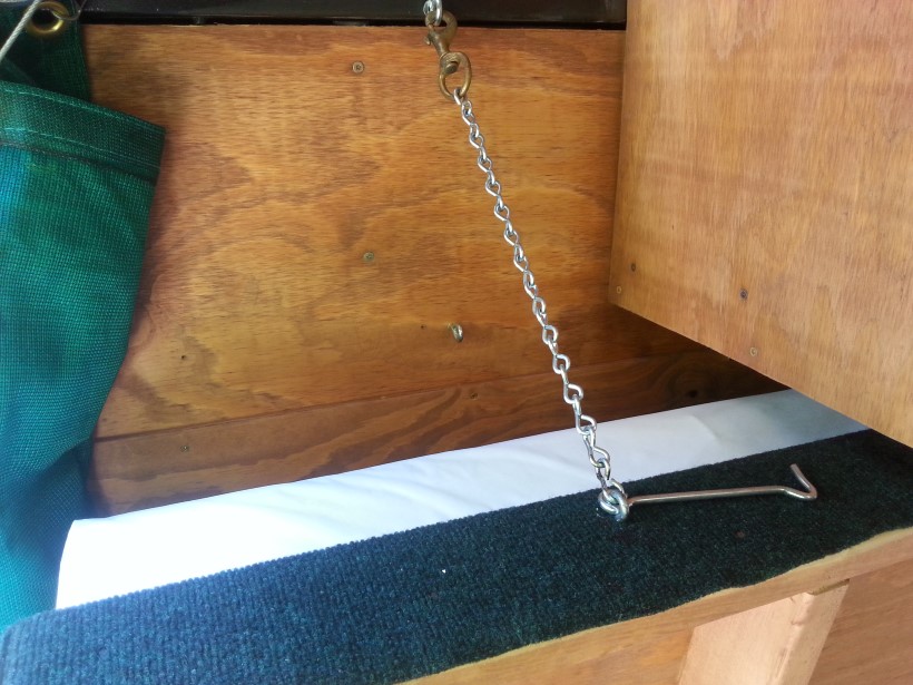

The first pic shows how one time I just could not make the eyelet to hook up. I had to use a 4x4 wheel chock to hold the bed up.
If you plan on a folding bed like this, just some thing to consider. Its tight and a little awkward to bend down and lift in that small space.
I really don't know what I will do at this point. Maybe nothing. :thinking:

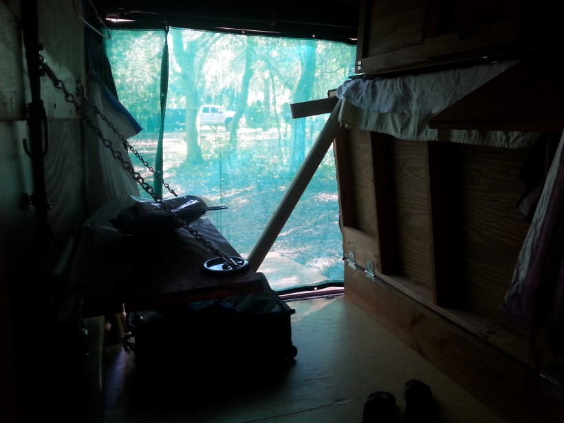

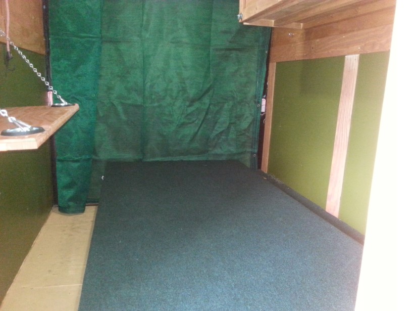

I think I would mount the winch where the top chain eyelet is now. Move that chain and eyelet forward to perform the same task. Push a button from the coat rack ares and the winch goes up or down in the rear quarter of the platform while I lightly hold or assist the forward portion. That's It. :thinking: :thinking: :thinking: :beer: :beer: :beer: 57 dollars and that could be it.
