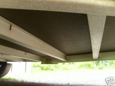

Postby Prem » Mon Aug 31, 2009 12:04 pm
QUESTION
I want to insulate the floor of my trailer from the underside.
I am contemplating using 1 1/2 inch block foam (pink or white) glued in place. It will need a covering that I can only apply by putting the trailer up on blocks and jack stands and then working upside down underneath using a creeper. :SG Sheet aluminum with rivets seems to be overkill and would add a lot of weight and be hard to fit. I thought of bed liner, but applying a liquid upside down is probably not going to work well against gravity. Whatever it is, it has to resist high wind speed going down the Interstate.
ANY IDEAS anyone
:QM :QM :QM
Prem
My goal...
...is to live in a trailer.
Prem

Postby ARIZONA GUIDE » Mon Aug 31, 2009 6:37 pm
I do not see anything else that would work other than some kind of fiber glass sheeting or a carbon fiber of somesort. it will still have to be hooked by riv ets or self tapper screws. It has to be something solid to keep water out. Doing this will also help with drag and fuel millage. Like nascars and my r-vission trail lite camp trailer. they are fully sheeted in underbellies for the purpase of not drag.

Postby hunter535 » Tue Sep 01, 2009 8:47 pm
What ever you put underneath, I would think that it would have to be able to breath. That is to allow any moisture that can build up between the floor and the covering/insulation can escape through the covering. I have thought :thinking: some about this myself with little success so far.

Postby Prem » Wed Sep 02, 2009 12:27 am
hunter,
Well, if it can breathe, it can let in lots of moisture. Not good. It needs to be sealed during dry weather (which we have here until later this month).
I used to use pour-in, 2-part, expanding foam. The stuff is fabulous! I poured the steel floor entry wells of my teardrop with it. It expanded 3 inches. Unfortunately, it requires gravity to hold it down while it expands! Can't do it upside down. Argh.
I'm thinking about using the jumbo cans of spray foam and putting the covering on first, then injecting the foam.
What do you think?
Prem :roll:

Postby hunter535 » Wed Sep 02, 2009 8:17 pm
Prem,
I have seen professionals on the tube use a spray foam product and they do ceilings with it. Let it expand and then trim it with a long blade on a sawzall. You can also buy this foam product in farm supply catalogs. All you need to supply is some compressed air. Not sure if this would work or not. :thinking:
Yeah your right about the breathable cover. I was just thinking if h2o got in there some how, how it would get out. I am sure whatever you use to cover the insulation will work as long as the seams are sealed up good. Lighweight and waterproof! And fairly inexpensive!

Postby hunter535 » Thu Sep 03, 2009 5:26 pm
That is the million dollar question Prem.
I am going to hold off for now on insulating the bottom of my CT until I am completed with my build. Just in case I decide to install a tank, more electric, plumbing of some type, etc. But I am thinking when I do it will probably be 2" Dow foil face polystyrene. I used the 1" in the walls and I like the product so far. It seems to insulate the trailer really well. I have not had the chance to use it in cold conditions but in the mid day sun, the inside is bareable. Warm but bareable.
As far as the covering for the bottom, ????? :roll:
I stopped on the way home to peek at the bottom side of some Forrest River campers and they seem to have a cover that looks alot like house wrap but thicker.? Not sure what it is. I think I may send a email to one of these manufacturers and see if they can tell me what it is. If I get an answer, I will post it.
