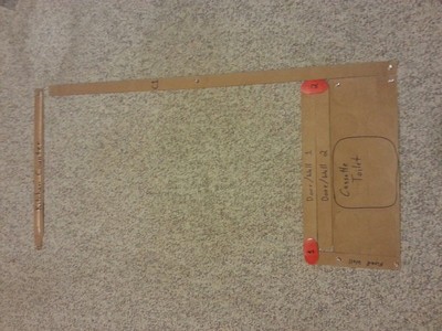

Now that everyone is put to bed, I took some time to get out my utility knife, a ruler, a coke 12 pack fridge box and some pins. The photos should explain much better how this might work.
Now lets see if I can link them properly... (nope)
(text images to my email to re-size them...NOPE, find online image re-sizer...)
Closed for travel or kitchen use.
Small configuration for 'quick trips' or when someone is using the kitchen sink.
Medium configuration with sink available.
The red ovals 1 & 2 are hinges that allow basically 360 degrees of swing. I'll post this and edit it into submission, sorry if anyone gets bombarded with notifications. :?

Postby WoodSmith » Mon Jun 15, 2015 11:01 pm
Still a noob when it comes to pictures - sorry.
Daddy! I'm changing! A little privacy please!?
Doors open all the way for easier access to the cassette toilet.
Wheew, that was :frustrated: painful.
So, under pivot point 2, a small caster could be mounted to carry some weight. Rare earth magnets could be used to keep things in more or less the right place during use, with some bolt catches or hook latches to secure things for transit.
The hinges can be made of wood, with steel pins, given what I see of the rail and style storage area under the bed, you obviously have the tools and skill to make them. The size of each door can be adjusted to provide more or less space, I think that messing about with a full size mock up using cheap yard sticks might be in order before committing to real wood.

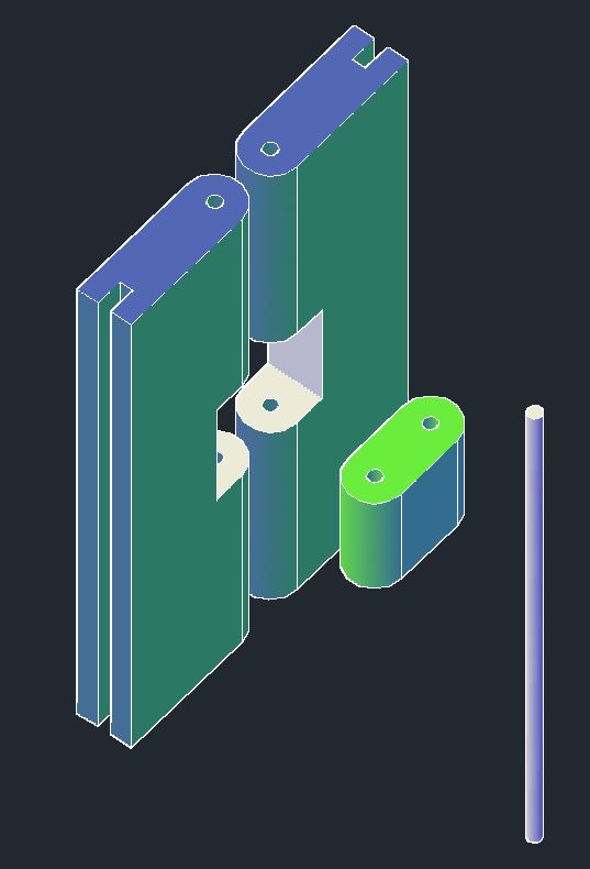

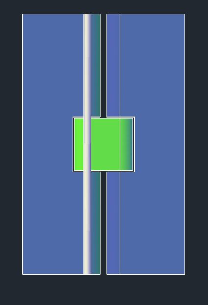

So, during lunch I spent a little time messing with AutoCAD and drew up the hinge that I see for this kind of door.
dbl swing door iso.JPG (35.73 KiB) Viewed 5244 times
dbl swing door front.JPG (23.84 KiB) Viewed 5244 times
One downside is that the double pivot point makes the door a little floppy, but this can be fairly easily fixed with some cheap gears (like 10 for $4 from SurplusShed.com) fitted to the pivot point. The gear forces the double pivot, which is needed to get the 360 swing, to act like a single pivot.
The blue parts would be full height stiles, probably laminated from matching 1/2 inch thick stock in order to machine the hole and install the hinge pin. The smaller green pieces might best be made the same way, but not glued into lamination, but rather screwed together so that the doors can be removed.
