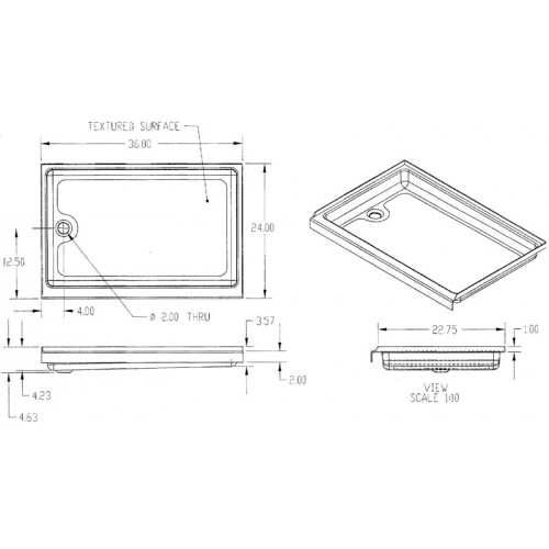

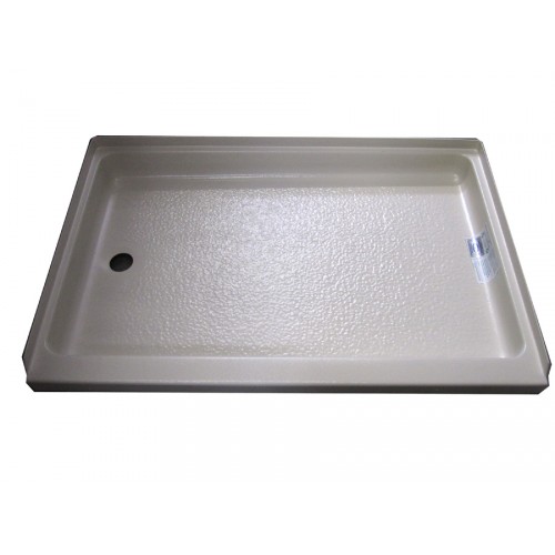

I ordered this pan from Jazz Sales. The price was not that bad, but the shipping is high. Ugh.
As noted in another post I just made, I will run the drain straight through the floor into a 5 gal water tank. Showers will be of the "Navy" type.
