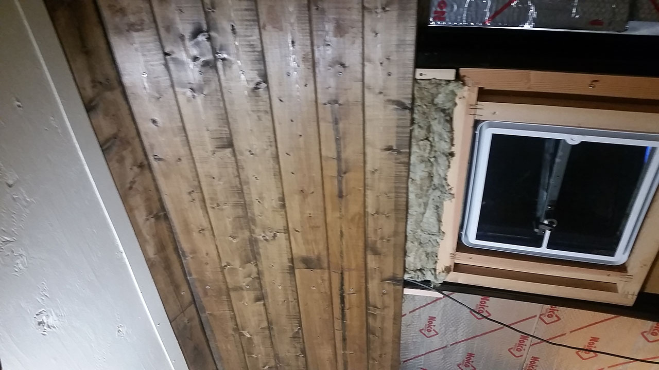

Postby Mark959 » Thu Mar 08, 2018 9:33 pm
trailer ceiling.jpg (167.47 KiB) Viewed 5281 times
Only pic I could snag right now, thats before I installed a light, the wiring is there for it. I installed four 12v 10w can lights, they are only about half an inch thick
You can see some of the rock wool insulation, noico sound insulation, sill seal I used between the ribs. The only issue I had with the noico is that they folded it in thirds, otherwise it seems to be helping greatly. Rain collecting on trees no longer sounds like a full auto versus tin cans :lol:

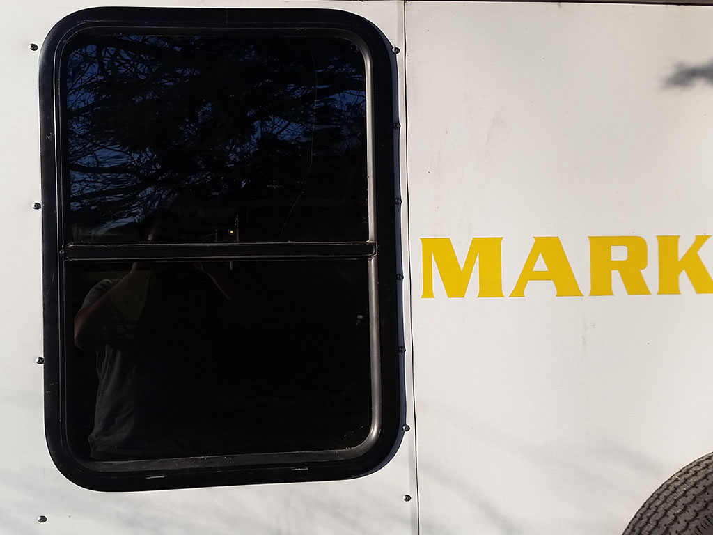

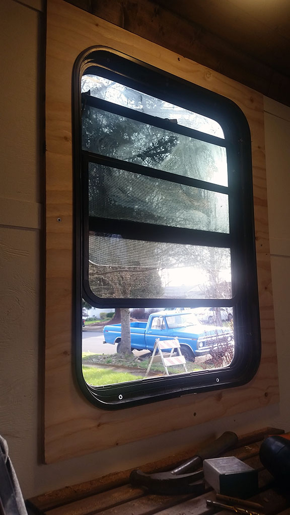

Postby Mark959 » Wed Mar 14, 2018 9:56 pm
Pics of the new and last window:
window 1.jpg (126.69 KiB) Viewed 5099 times
window 2.jpg (103.43 KiB) Viewed 5099 times
Getting there!
