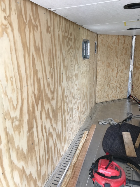

Postby featherliteCT1 » Thu Jul 06, 2017 11:26 am
At long last, I substantially completed installation of the insulation in the trailer and was able to install new plywood walls. Man that took a long time. The middle layer of insulation with all the custom cutting and fitting took a long time.
170705 Driver Side Plywood 3.jpg (193.74 KiB) Viewed 3857 times

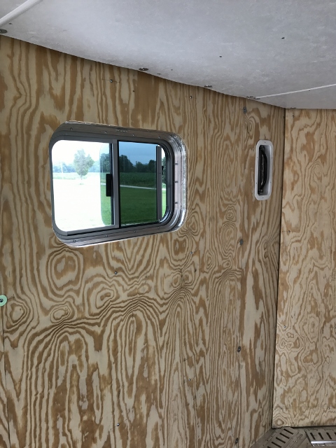

The cutouts for the window and the wall vent turned out OK. I still need to install a bit more insulation and affix some kind of cover for the cove area where the walls meet the ceiling. In so doing, I will cover the fender washers along the edge of the ceiling.
170705 Driver Side Plywood 2.jpg (194.97 KiB) Viewed 3857 times

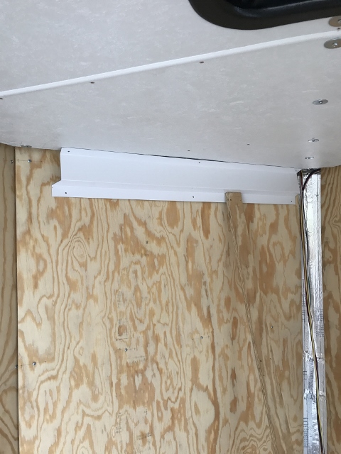

Here is a piece of the factory cove covering made out of white sheet metal that was installed all around the ceiling . It really looks nice. However, I am thinking that I will cover the cove area with a smaller piece of trim board because the sheet metal takes up about 5 inches of valuable wall space. A smaller trim board will give me more exposed plywood and the ability to affix things higher up the wall, closer to the ceiling.
170705 Cove Sheet Metal.jpg (168.8 KiB) Viewed 3852 times

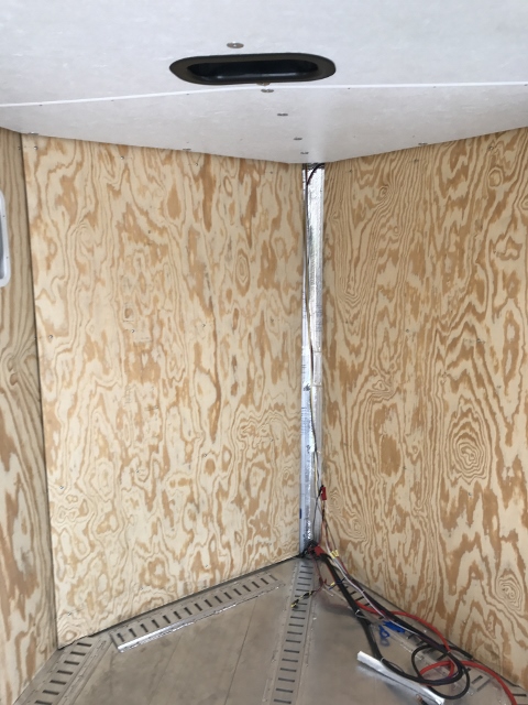

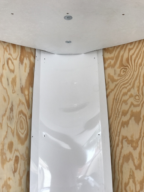

Here is the factory cover for the nose area that covers the wires ... made out of white sheet metal. I was going to reinstall this sheet but now think I will affix a 4 inch wide board ... maybe plywood. The wood will give me something to anchor onto when I start affixing things in the nose area. I do not think that the sheet metal would work as well because it is a bit flimsy.
170705 Nose Sheet Metal.jpg (130.32 KiB) Viewed 3852 times

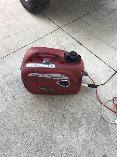

I just bought this Powermate 2000i generator from Walmart for $488. From my research, I believe it is a private label made by Yamaha.
powermate generator.jpg (233.42 KiB) Viewed 3778 times

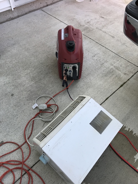

I was pleased that the generator not only powered up an old 8,000 btu window air conditioner, but also operated in economode with the air conditioner on high cool and high fan. The plug for the AC unit is too bulky to plug directly into the generator so I had to use an orange extension cord to make the connection. To ground the units, I attached a jumper cable that runs from the ground post on the generator to a metal rod I drove into the earth a few feet away to serve as a ground device.
generator and air conditioner.jpg (218.13 KiB) Viewed 3778 times

Postby Padilen » Sat Jul 22, 2017 12:25 pm
That's a nice generator. My Champion 2000 powers my 8000 Btu too. Is yours quite? I don't think Yamaha is the manufacturer. Could be or could be a copy.
Just did a quick Google it was an Italian family owned company until Generac bought. In 2016.
Sent from my XT1635-01 using Tapatalk
