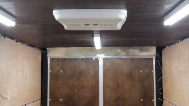

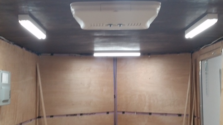

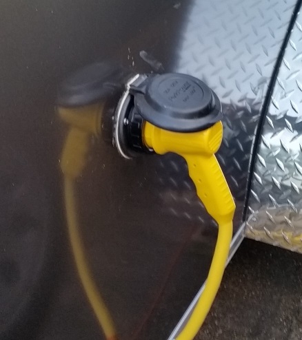

I couldn't help myself. I only needed a tiny item before finishing up all the electrical work on the trailer. Well, I got it completed this evening! Yahoo! I hooked up a 15 amp adapter to be able and check the lights and receptacles... All I can say is: "Houston, We've got Power... Ready for lift off!" Now, If I can get the trim back on, the messy caulking off and the new on, walls painted, floor prepped and laid, crown molding installed, base cabinets attached to wall.... (you get the picture :-)

I forgot to mention that I ran three separate lines for the lights. One for the bedroom area, another for the kitchen and dining area and one for the bathroom itself. This way if one line has a problem, the whole lighting system won't be at a stand still. But also it will be nice to turn off the lights in the kitchen/dining area while watching TV. I can't stand to have bright lights on behind the TV while watching!... Did I say "Yahoo!"

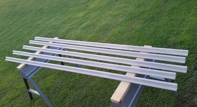

We got the wall trim up with the exception of the metal trim in the center and the two in the rear. The DAP spackle stuff was just what I needed especially for the staple holes. We used one coat of Kiltz primer and two coats of a latex interior paint. The color we chose is called "coffee house". It looked like it had more tan in it at the store. Maybe it will darken a bit once it dries. It looks like the two coats will be sufficient, but we will wait till it dries and see if we need to hit it again. We still have some ceiling molding to finish painting. It came primed and we put one coat on ourselves. It looks like it will need several coats. We also need to stain and poly the ceiling trim that runs across the trailer. Weather permits, I hope to prime and lay the floor sometime next week. Yahoo!

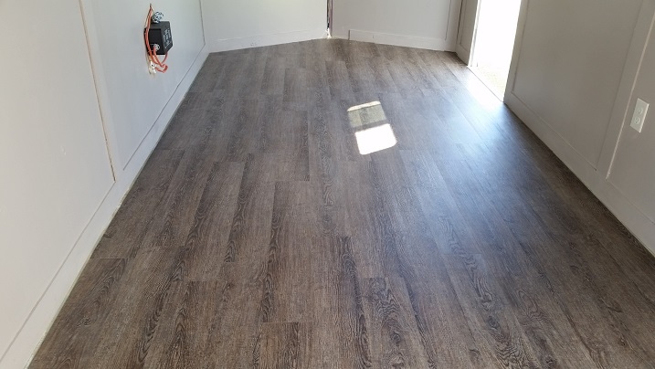

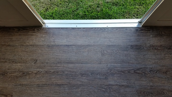

Well... we just got the flooring installation finished (minus the quarter-round around the walls). I used some Henry's brand patch stuff to level any minor divots. Then two layers of Henry's 336 Self-Stick Tile Primer to prepare the wood for the peel and stick panels. Then finally, we used some gray ash vinyl panels to complete the job. We are happy with the look and hope the panels will remain stuck down when all the seasonal temperature changes take place.
