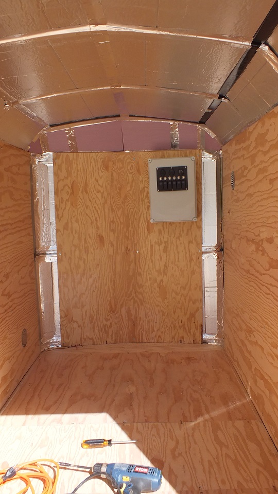

Turned out to be nice outside, so out to the backyard to work on some of the electrical.
I got my intake and exhaust fan wired, mounted and tested. They are doing what they are supposed to.
I also got the big electrical everything box installed. As I install the new electrical devices, I can now run the wires to this box. Had a heck of a time cutting the four holes for the wires on all four sides. They are really terrible, but then, who will see them but myself. I need to find some kind of rolled rubber padding to install in the opening to prevent wire chaffing, something like a very flexible rubber tube that is sliced down one side. That way I just slip it on
Everything like my Television and other types of entertainment equipment will go up on the forward bulkhead like I placed the electrical box.

Postby McDave » Sun Feb 18, 2018 3:47 pm
CaleyAnn wrote: Had a heck of a time cutting the four holes for the wires on all four sides. They are really terrible, but then, who will see them but myself.
Hole saw?
