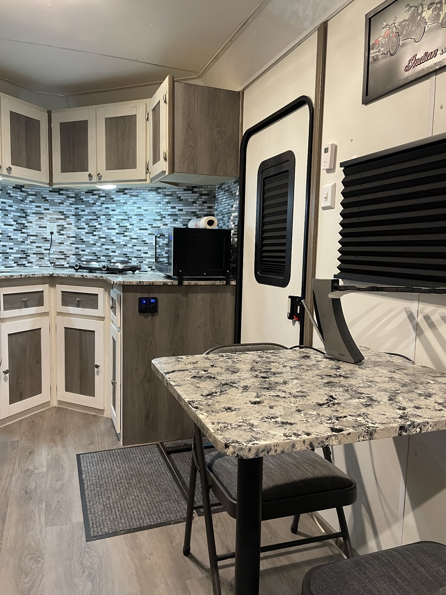

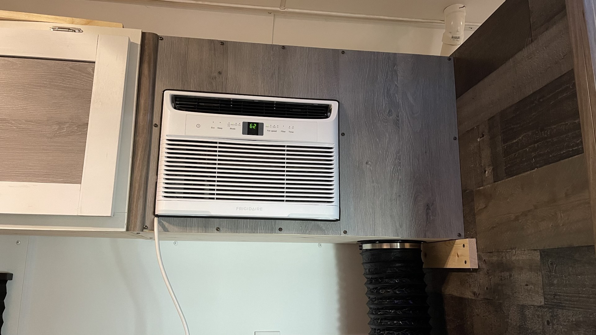

Added a 1200W pure sine inverter to power the fridge when driving, running on a 100Ah VMAX AGM battery.

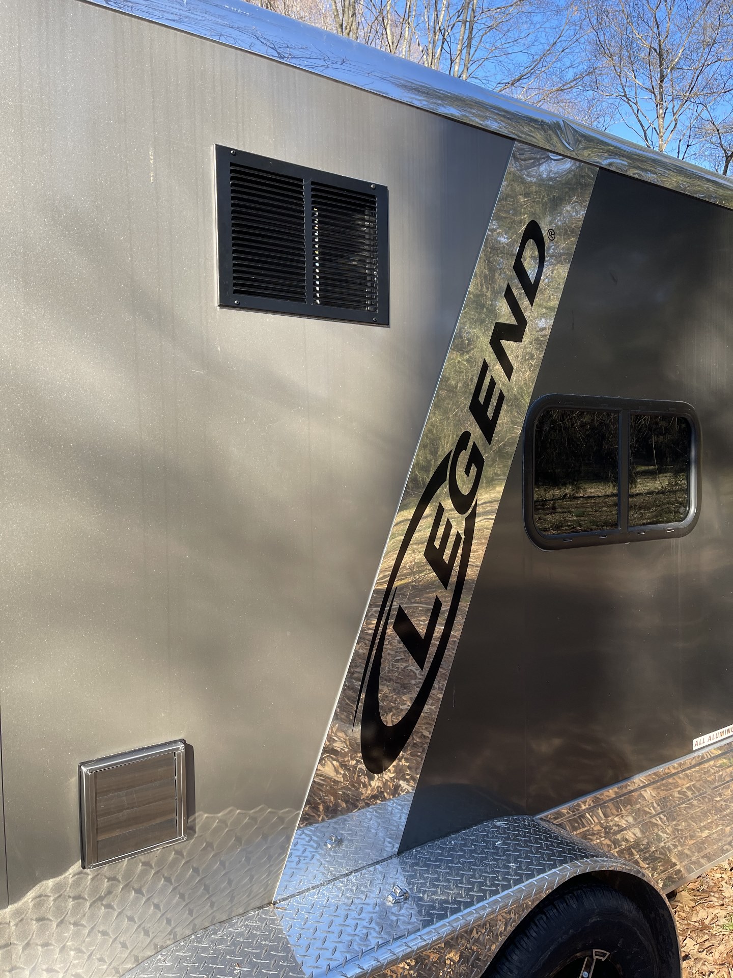

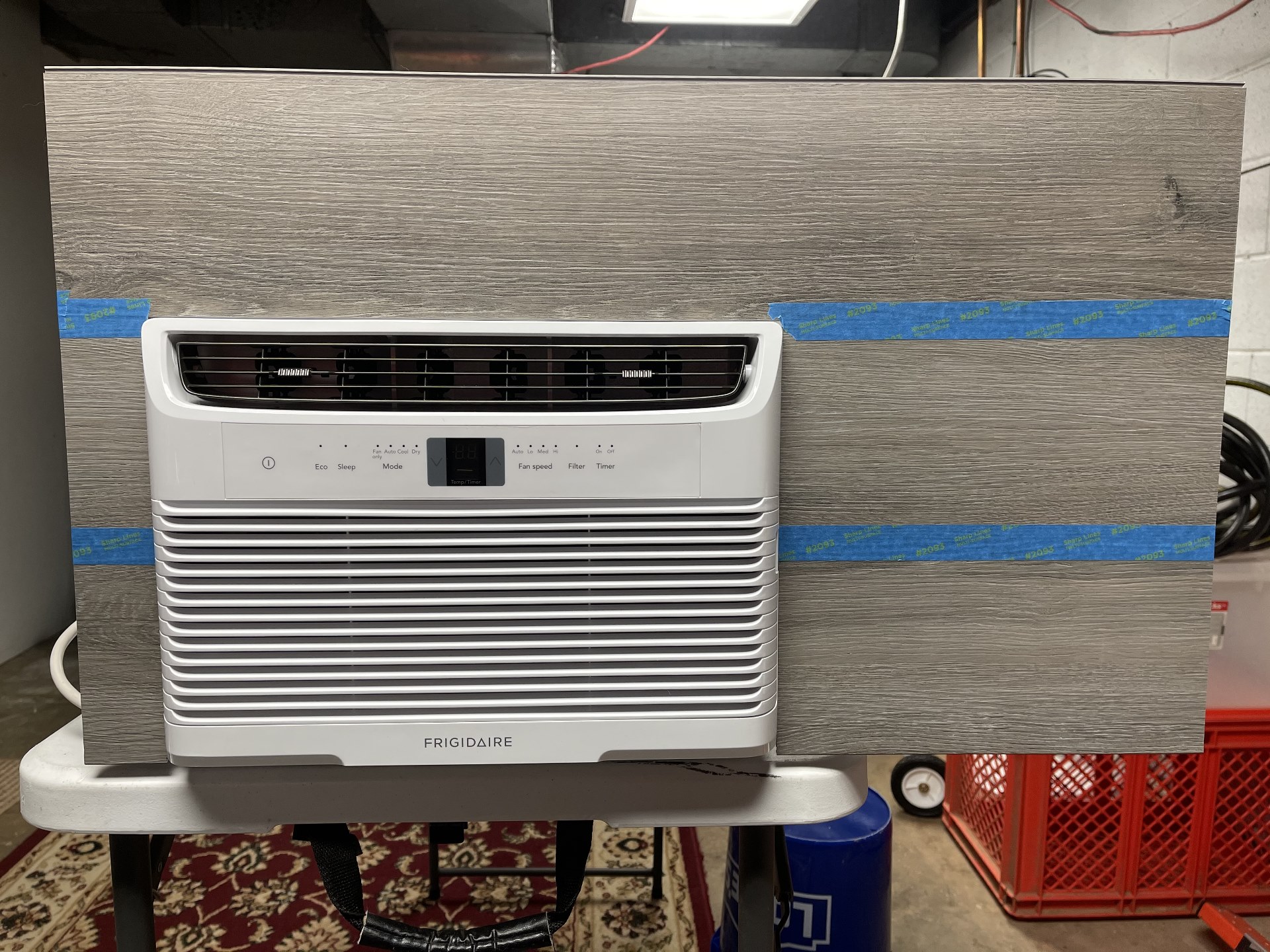

Starting on the final AC project install. Picked up a 6000 BTU Frigidaire unit and will build a cabinet/plenum with exhaust vent for the condenser in the side wall.
I will repurpose existing exhaust vent I had previously installed for the portable AC unit to use as an outside air intake for the new AC unit. I'll connect with circular duct to the plenum intake.
Gonna try to use some left over vinyl laminate floor planks to finish and close off the AC cabinet.
Not sure about how to deal with condensate, the unit i purchased has no drain outlet, I assume window units are designed to just "spill" over the rear cabinet lip to the outside?
Here's a few updated pics of CTC and the AC layout.

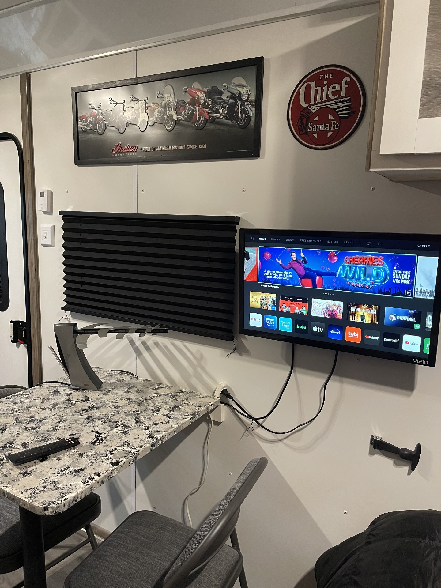

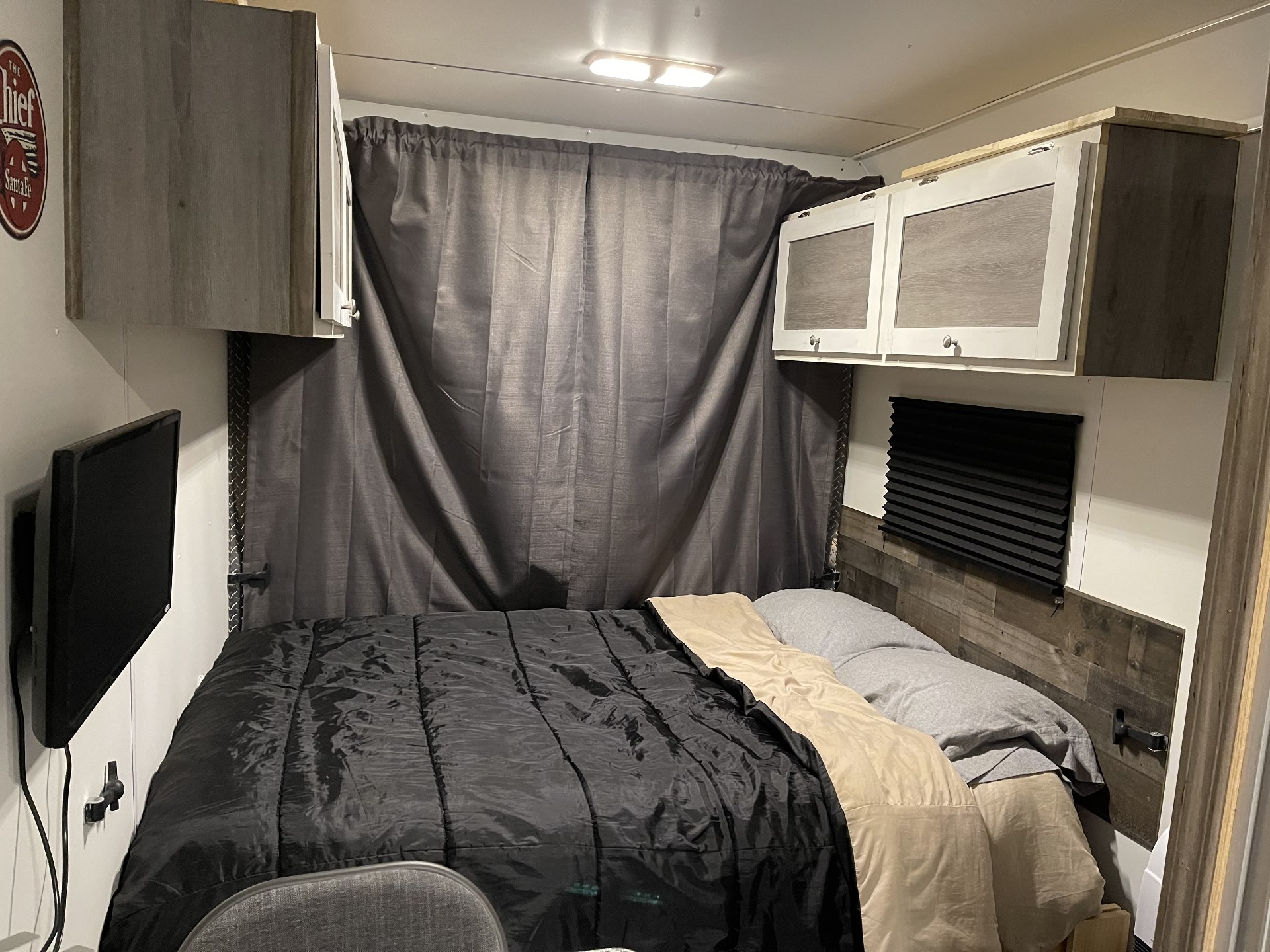

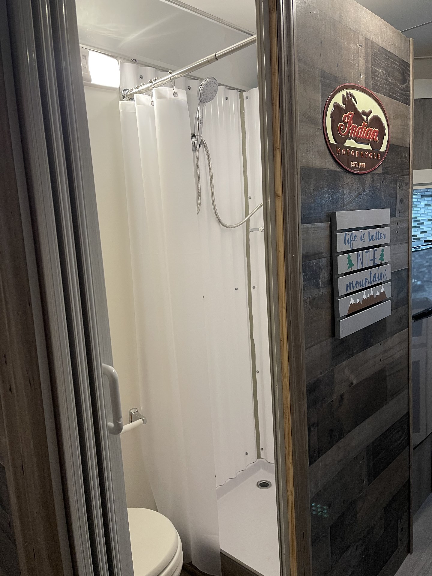

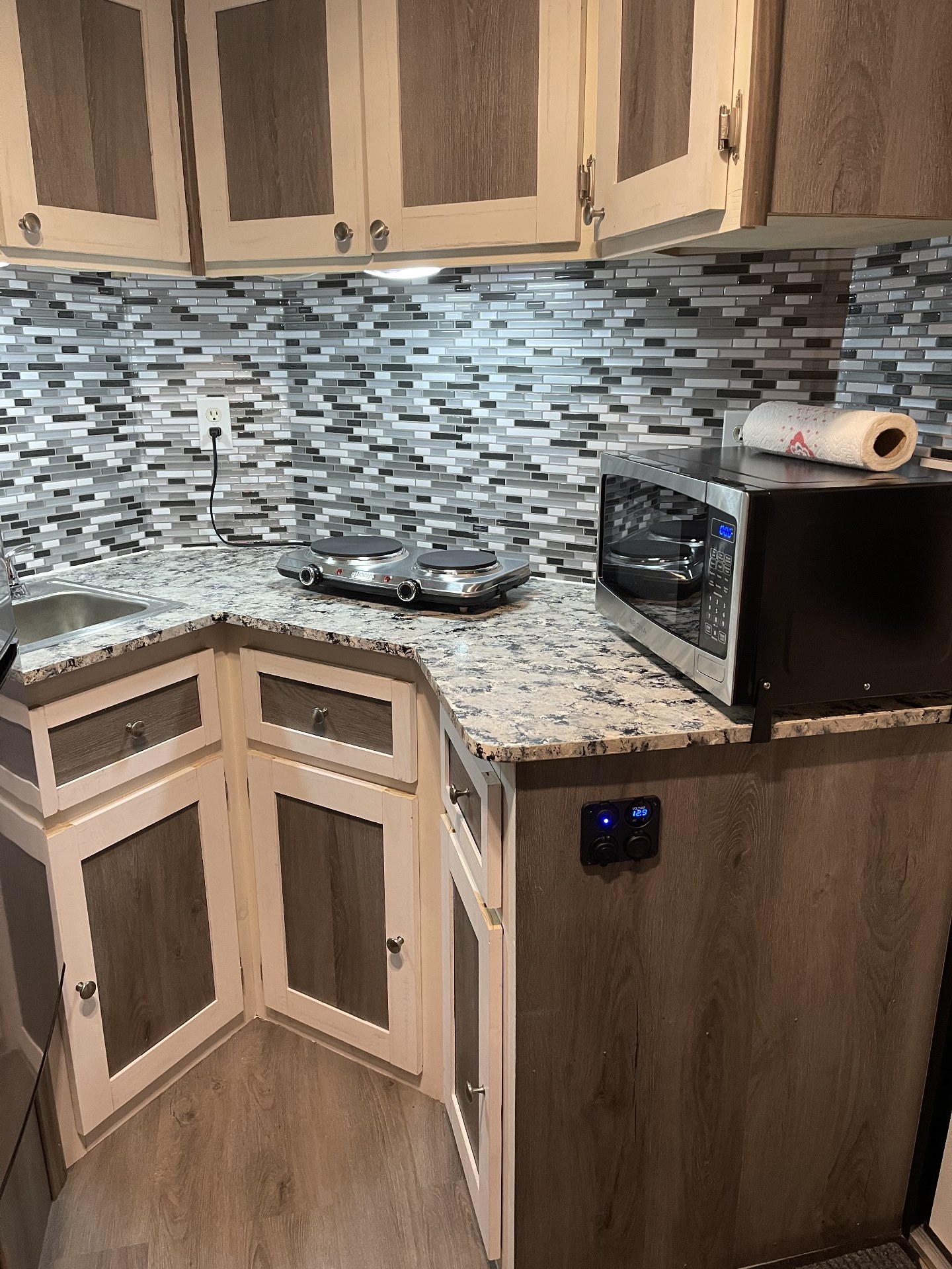

A few updated pics. Still haven't painted cabinets! I hate painting with a passion, LOL!

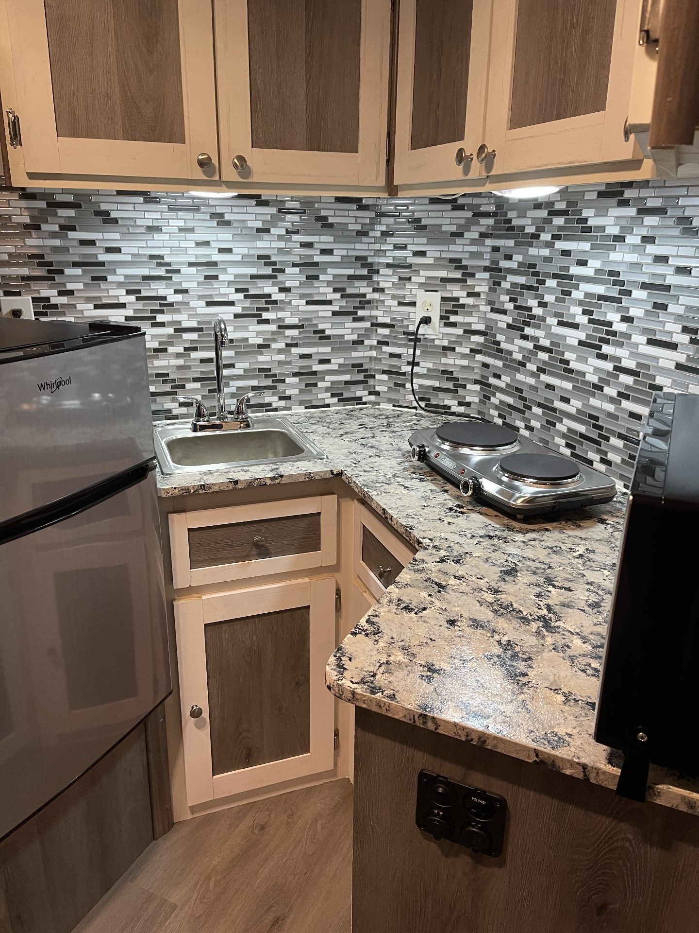

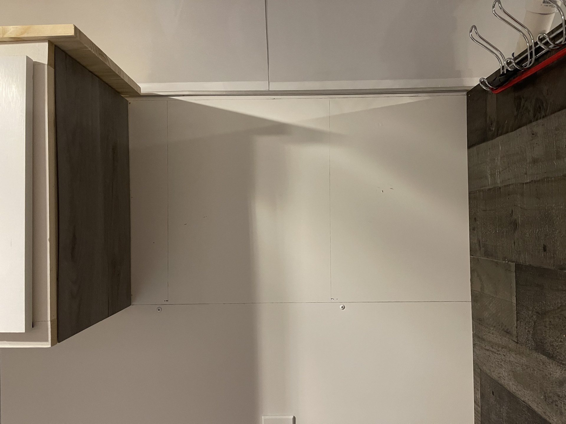

And a few more

Some of the new window A/C units have a low spot you can connect a drain tube to drain the water. (did not put a drain hole in our A/C) We have had no problem with ours except when the humidity gets over 92 % or near there. Then we will get a splash of water over the lip in the back. Seems like sometimes the fan tips sling the water up on the coils or something which makes it evaporate. Not sure how it works just know my a/c is vented into my camper utility room built across the back of the trailer and only had a small amount of water on the floor twice after exploring the UP of Michigan for 4 months.

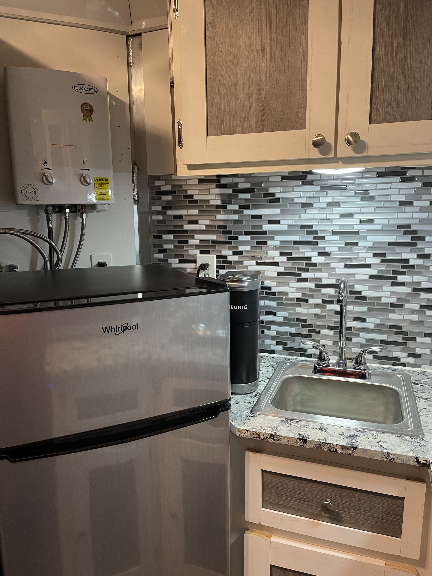

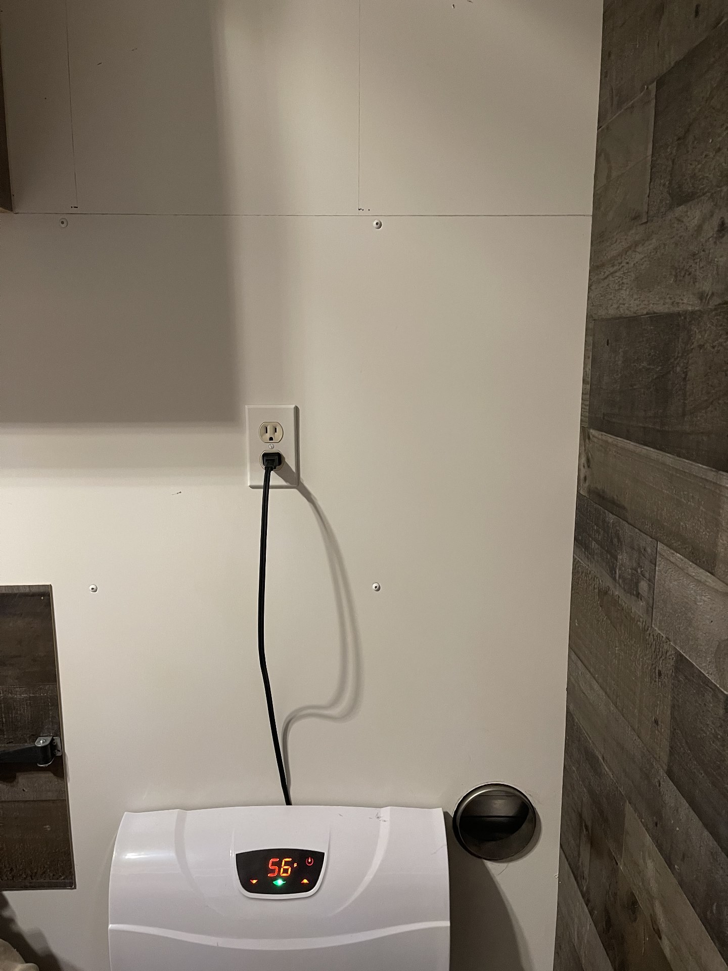

I saw your Excel water heater in one of the pictures above. Is your water heater ventless or does it vent out the rear of unit? I am considering mounting one in similar location and I have a side vent in the same location that I thought might work for venting, prefer not to go thru roof. I don't have a problem with using vent-free as I have a MaxxAire fan about three feet away from where the water heater would be.
Also, how do you like that water heater? Anything you would do different about it?

Richard, I think you got it. Most of these new window units are "slingers" which are designed to throw the cool condensation back onto the hot condenser coils to evaporate and increase efficiency. The trouble is when you have high humidity and get more condensation with less evaporation. In that case, they will overflow. I drilled a small hole in mine and added a fitting for a drain hose if water gets too high. Living in Florida, mine would overflow frequently. In a dryer climate, it is not a problem.
Thanks!
Harry :)
Harry
My heater is a vent free unit, with built-in safety shutoff. Regardless, i don't plan on running it without the Maxxair fan in ceiling running. The heater comes on and off automatically based on water flow, system works great so far.

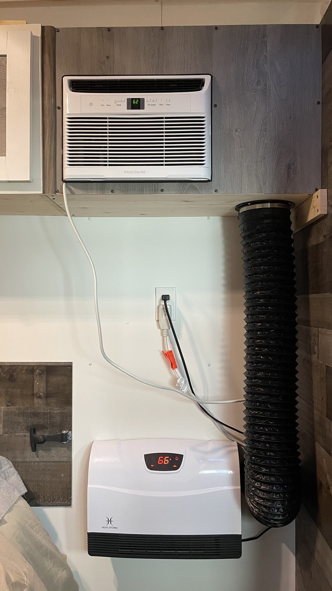

Postby chiefvintage » Mon Feb 22, 2021 7:41 am
Finished up the AC install, ready for the swamp!
