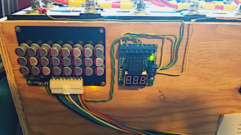

Since my cells have a self-discharge going on, and they seem to discharge at different rates, I got one of those "active" balance boards to keep the battery top balanced.
There's a spot on the board where a switch can be added. Otherwise the board is balancing all the time. No point in trying to balance the cells when they're under 3.4V each. So I found a programmable switch that turns on or off depending on voltage. There's a threshold separating the on and off function so it's not getting triggered a bunch while the cells are right at 3.4V. It even shuts off the display after a while so as to not use extra power.
Without the switch and balance board, it takes about 20mA to keep the battery at full voltage, and the difference between cells is always more than 100mV. With the switch and balance board, the battery takes 30mA to stay topped up, and the difference is only 12mV. I ran an air conditioner and a mini fridge for a few days, along with a power supply to simulate a bit of solar input. The battery periodically got low enough in voltage for the switch to shut off the balance board. With the fridge and A/C compressor cycled off, there was enough power to recharge the battery, and the balance board kept everything within 50mV as far as I saw.
