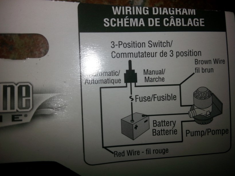

Hey Don,
There are 3 wires coming off the pump. 2 go to the switch 1 goes right to the battery per instructions. AND GUESS WHAT!
I thought it would be good to ground the switch by tapping into the pump ground wire as there was a green screw on the switch. It is a 120 volt light switch I just wanted to try.
I DO BELEIVE YOU SOLVED THE PROBLEM. :thumbsup:

But the black wire goes directly to the battery ground. The red goes to one side of the switch and the brown to the other. Im sure I hooked up the battery pos wire to the pump pos wire and then to the top screw on the 120 volt switch. Then the brown pump wire to the bottom screw on the switch. Then I hooked up a ground wire from the green ground screw on the 120 volt switch to that black pump wire that goes to the battery ground directly.
I believe the instructions made no mention of grounding the switch but I thought how could I go wrong.
That is what I did.
If the switch works like on the boat, the pump will not only come on automatically but will come on when you flip the switch.
But I had to disconnect it. :thinking: :thinking:

I got it. Just LOOK at the damn directions man. I was tired at the end yesterday. My knee. I need an MRI, chit!
I did not use a three way switch and I did not wire like it said. I tried to use what I had. But Now I know.
I like the rocker lighter switches like on the boat.

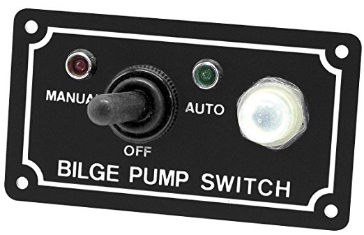

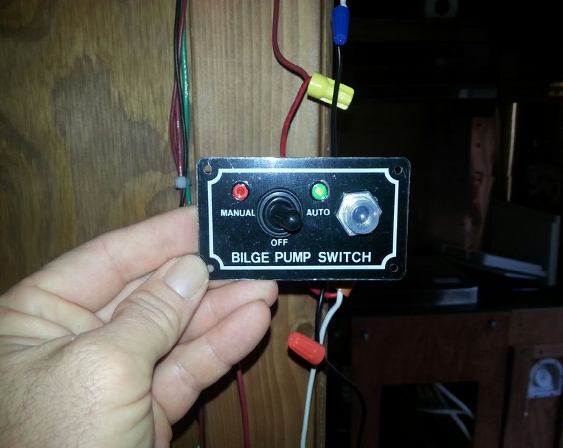

Postby Tommy B » Tue Feb 28, 2017 8:38 am
This should make things easier. Its the same brand as the pump. I chose a toggle over rocker switch. Like the lights. That white thing is a circuit breaker reset I believe. :beer:

Postby flboy » Tue Feb 28, 2017 10:20 am
Will need the ground for that switch only for the indicator lights grounding.

Postby Tommy B » Tue Feb 28, 2017 10:54 am
OK Thanks Don. I read the reviews and I think the instructions are back wards. Hope I can figure it out.

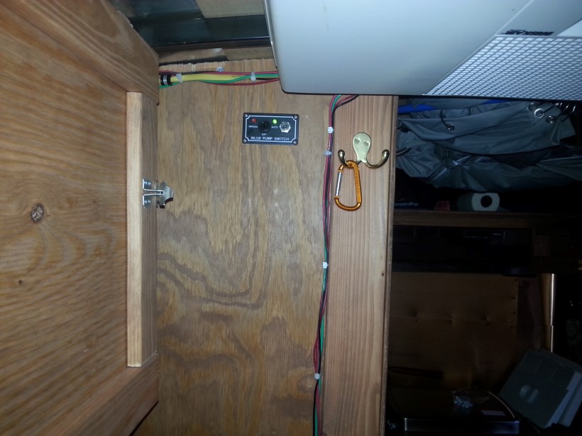

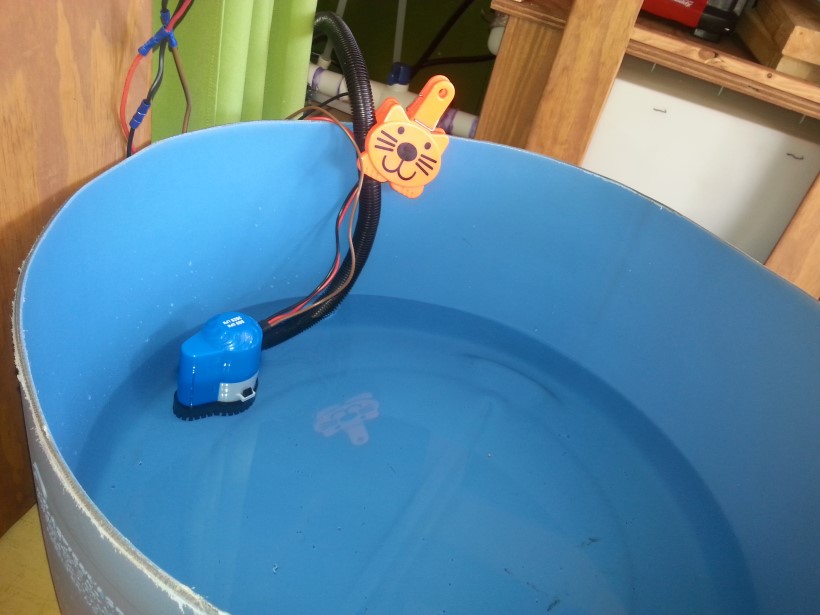

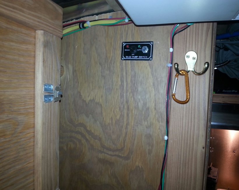

Postby Tommy B » Thu Mar 02, 2017 8:52 am
Working on it. Got the wires figured out. Looks retro to me. 8)
This is a rough in of course.
Its high and out of the way. Will be to the left and in front of the shower curtain opening, basically.
The back side is in the toilet area and will not be seen too much but I will try and square it away as best as possible. :thinking:
I did not notice the plastic coating yesterday. I will peel it off when I take it back out to connect the wires with butt splices. Touch up the stain a bit.
That pump runs fast. Will be fun to see if I like auto or manual. The lights remind me of old sci-fi control boards. :D

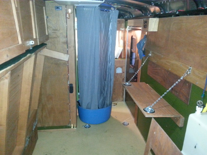

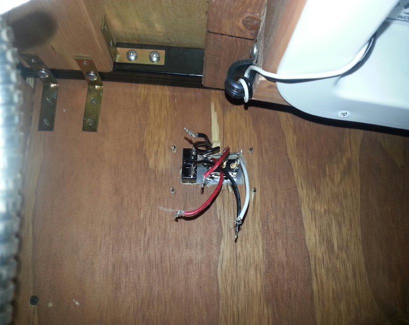

Postby Tommy B » Fri Mar 03, 2017 7:01 pm
Ok, still working it. But this will work very well.
Just one or two more pics below. Maybe what NOT to do. :shock:
6x12 trailer. Flushing toilet, shower, stove top, portable refrigerator, freezer, full size mattress/bed ( I think ). Sink. So much more! Hahaa!
I'm getting attached to it.
Just a small 19 inch walley mart smart tv, and acc. maybe.
I want to find stout retractable legs for the bed now, as that was my plan originally. :beer:
