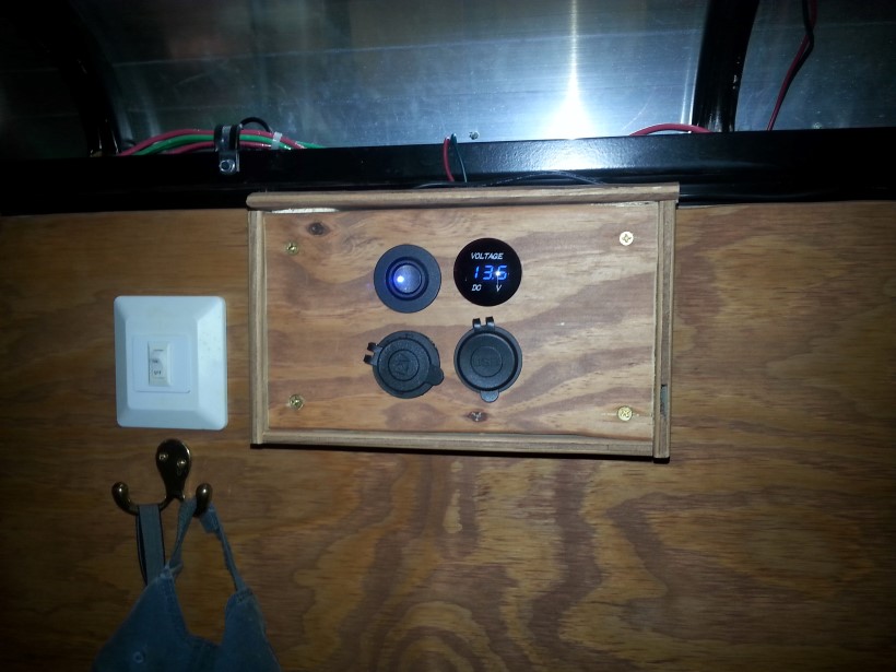

Postby Tommy B » Thu Mar 09, 2017 8:55 pm
Hey Don after 24 hours it only pulled the battery down 12.7 to 12.4 .
I am good with that. I feel its working fine. Thanks I plugged in the shore power and the charger only went to 13.6 I feel good with that too. :thumbsup:
I really appreciate your input and help. Seriously.
I also replaced the five or so fittings and have pressurized the lines. No leaks yet. :worship:

Postby Tommy B » Fri Mar 10, 2017 9:07 am
Mcdave, thank you!
I very much understand it now. Yes I do. :thumbsup:
So with that info,
The meter and dc socket set are wired to the Old DC buss panel which is wired directly to the battery. I bypassed the progressive power center as I thought a direct route would be better. I would think This would be fine. The size wire I used and the route I choose.
So in 24 hours of running with the maxx air fan on for 12 of those hours it drew the battery down to 12.5 from 12.7. Please, would you consider this good for a cooler/freezer. Consumption wise?
ONE SMALL NOTE, I think I remember that after I tightened the wire harness up, The meter quite working and I did think I tightened up the wire holder farthest to the right there too much as there was NO movement in the bundle. I loosened it and the meter worked fine. May be nothing as it seemed to read fine after that, BUT maybe I flattened the wire some. :thinking: I will check this. But I may have just had the battery switch turned off. Cant remember.
If .2 amps drain is good for 24 hours I am fine. The unit is rated at 5.5 amps when cooling a warm cooler so 1.3 amps when cool may be normal.
I will take a peek at the wire bundle but am ready to let this go.
