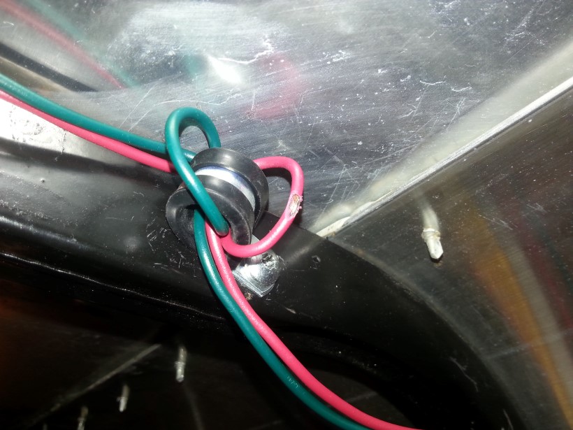

Well Well look what I found. Splaines a few things. I thought I remembered an issue here. Loosened clamp an rotated wire. :shock:
Also checked trailer after 72 hours and found battery down to 9.1. :shock: Checked battery post and found the main hot coming from the Progressive 4135 sheared off. Last time I seated the battery box cover I did that. Fox, really, what next. :thinking:
So when the Dometic compressor kicked on the meter in the trailer went from 13.4 to 12.4. Better then 11.3 or so but the battery is stressed right now. Will update later but things are looking up.
Was going to camp this weekend but temps are diving into the mid 30s or upper 20s in the forest. WTH! My knee is still bum. idk.

Wow! If that was touching ground and it is a +12VDC wire... it should have blown a fuse.... otherwise, it probably wasn't the source of the voltage swings as I don't see any major strands broken or etc.. Are there a lot of strands broken to reduce the Gage significantly that I am not seeing in the picture? What was that chaffing on to get so worn down? Almost looks like you hit it with a drill bit on the side.
Having the Converter sheared off from the battery would account for some swings, especially if you expected the converter to keep the voltage up.. Also, if you read 9.3 volts... you have diminished the lifespan of the battery by at least 50%. Sorry to tell you that.. but that is bad news for a deep cycle lead acid battery.

Chit, 50 % ? That is bad. You know The lead positive terminal from the progressive that sheared off at the battery terminal ? Well many strands where cleanly cut when I crimped the undersized ring connector on upon original installation, a year ago or so. I think It was a 12-14 gauge. I replaced it properly with a 10 gauge ring crimp on connector and routed it better to the terminal to prevent any tension on the wire at all when the lid is placed back on the battery box.
What puzzles me is why the battery was drawn down so much in say 72 hours with only the cooler running. I know it doesn't use that much. I saw a you tube review on this cooler and the guy said when his compressor came on his meter wen from 12.7 to 12.5. :thinking:
Don one day camping or what ever if you can through a volt meter to a few things/connections maybe if what I just did does not help.
One other thing. I finally checked the battery water level just prior to shearing off the connection and to my surprise it needed 1/2 to 2/3 of a cup of DH2O.
I sure beat this battery up, damn. :cry:

Postby flboy » Wed Mar 15, 2017 7:41 am
Yes... the low water could have been the reason also for the lower voltages because that exposed surface area of the lead plates are out of the picture if not in the water. Just fill it up and push on. Nothing you can do about that now. As long as it is taking a charge and giving you a decent amount of time between needing a recharge, use it. When it quits taking a charge... you will know it.

I don't know if I mentioned it but that battery is a deep cycle marine battery. It is only 11 months old and I took it back up to discount auto where I bought it and they checked it and said it was good but only 80% charged up at 12.2. Still had 400 CA left. That's why I took it up but I also noticed that my progressive charger was not working when I got home from work. Some time while charging the negative ground from the progressive PC had slipped out of its butt connector and was hanging low, I barley noticed it. That's why it quite charging then and before when I found it at 9.1 At that point I just took the battery up for them to check out as they said they would replace it if it was bad.
It failed because I used the butt connector that came with the battery cable as it had a 4 inch 8 gauge acc. wire you could use to hard wire in. I could barley crush the connector and it was too big for the 10 gauge coming from the PC and the connection failed.
So now all connections are right and tight. The meter jumped up to 13.8 when I finished doing it right. They said no harm was done at all as it is a deep cycle and is made to drain some. I am solid now and learned a lot. Time will tell of course but how do you feel about it now. The health of the battery. Just curios.
If I get home and that meter reads 12.7/12.8 I'm loading up and heading out early tomorrow for Ocala. Solo. Last cool trip till November. Knee still a little weak. Really want to take just the KTM but should just take the ATV. Will check out those big azz hill climbs and take a few pics. :beer:
