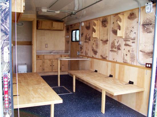

Check out my set up. It is a 6x10 and a queen size bed, (the one seen is only set up for twin, I removed part of the bed for transporting displays I was doing that weekend in Somerset, Pa.) added electric for heat and toaster, as well as lights. A porta potty that is on a heavy duty drwer glide that slides beneath the bed. A small counter is in the front and I want to eventually add water with a sink. I also added a 20" tv screen which includes a DVD player. Wife went with me on two trips and actually suggested some ideas for trips next year. She even said she likes sleeping in the trailer.

Do you have some inside photos of your setup?
southpennrailroad wrote:Check out my set up. It is a 6x10 and a queen size bed, added electric for heat and toaster, as well as lights. A small counter is in the front and I want to eventually add water with a sink. I also added a 20" tv screen which includes a DVD player.
Postby southpennrailroad » Fri Nov 17, 2006 8:18 pm
