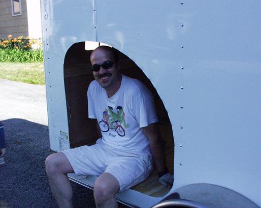

Okay, the new computer is here. I've got netzero installed. I've looked through some photos and found one worth sharing (but hardly), so let's see if I remember how to post it.
We've got some newer photos which I'd like to post but the new computer with a five-slot "universal" connection doesn't have a connection for the old memory cards for our camera!! We've got to take them to my Mother In Law to burn to CD, and then I can post. Would you belive I'm an IT professional? I'll get to the 21st century one of these days.

I'm looking forward to seeing some more photos. It looks like you are installing traditional teardrop style doors on you cargo trailer... I'm interested in your plan for the doors & windows.

Yes, they're Camp-In style doors and windows made from parts bought from Camp-Inn. The trailer is 5 feet tall inside. The door works, but it needs some finishing touches. Just got back from our second outing in it... and the kids punched out the screen. gotta repair that before starting on the next door.
