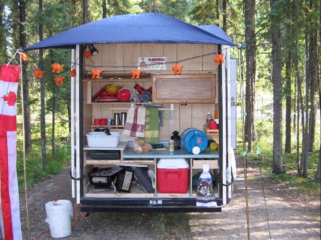

First off, WELCOME! Yes you can and it has been done by quite a few. I do like the V nose. It gets you some exter space without getting longer. I belive that you can get alot into a 6x12+. If I were you I would seriously consider building a galley inside the back doors. If you do this, think about a second way out of the sleeping area. (second door or a large window)
catrinka's attack cat
I would buy the trailer without the inside finished. This would alow you to wire, insulate and have a finished wall the way you want. It will be easier to add windows and vents. You could do a nice stained/polyed wooden walls and ceiling. This will give it a warm cabin like feel inside. Catrinka also has a floor plan. It is something to start with. Notice it has a porta poty in it. Go for it. Don't rush it and cut corners now that you will be sorry for later.
