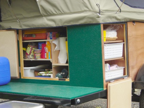

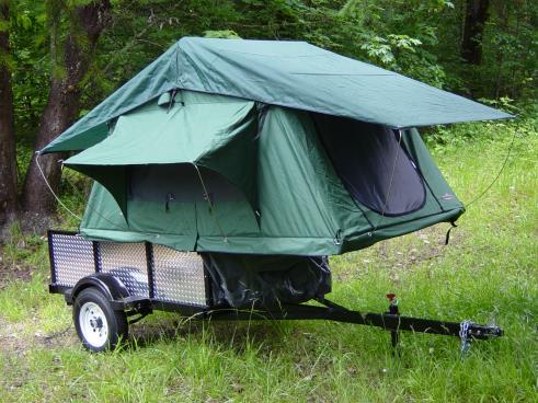

It's easy to make a all-in-one ATV haul and camp trailer. You start with a self contained tent unit on the front, pictured is a 4' x 6' trailer
Then use rubbermaid storage containers or build some storage compartments to organize your stuff
For the axle position, I would just cut the hanger loose, move the axle assembly until I get 10-15% of the trailers weight on the tongue and reweld them.

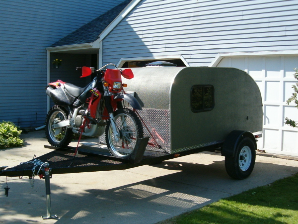

Postby elmo » Fri Dec 07, 2007 1:46 pm
Harley this is mine!!

The tent idea is cool but I'm trying to get away from a tent. I already use one and want to get away from that, trying to consolidate into a smaller package.

Elmo, wow, that's beautiful man! Did you make that yourself? It's awesome. I have seen one's like that for ATVs as well, just not mine. It's way too large to load sideways.
