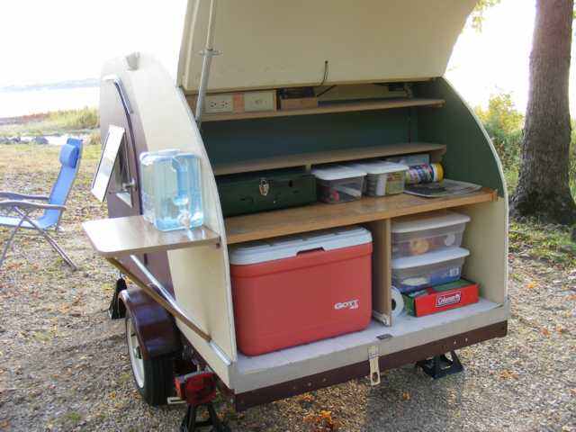

Another consideration...heat rises! A Coleman stove (any stove, really) throws off a lot of heat and that heat goes right straight up. If you cook indoors you will need some sort of heat shield / vent hood to protect the ceiling and backsplash areas from coming apart, melting, scorching or even starting on fire.
In this pic you can see where my stove is stored. I tried using it on the counter once and the inside of the hatch immediately got so hot that I couldn't touch it.
On my short list of things to do is to make a metal heatshield for the inside of the hatch in case I need to use the stove under cover at some point.
