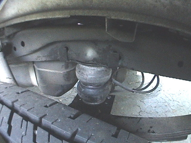

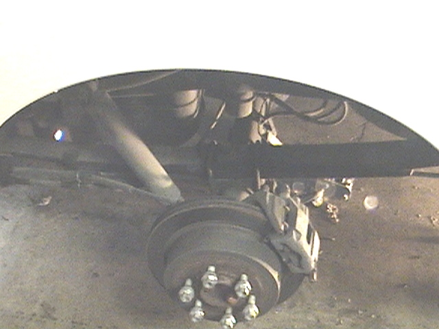

The Blue Max wrote: Firestone Ride-Rite airbags
Can't wait to see pics of the trailer. By the way I just put the Ride-Rites on my truck and love em!
